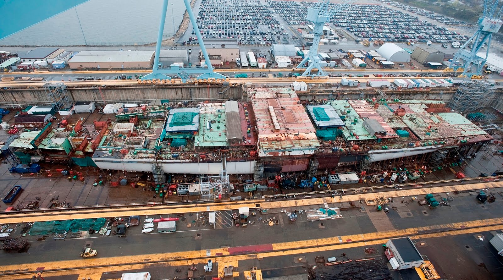

USS Gerald R Ford progress continues:
http://nosint.blogspot.com/2011/08/structural-work-on-gerald-r-ford.html
