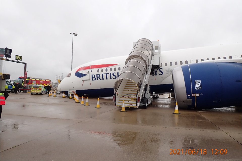

The jet, G-ZBJB (c/n 38610), was parked on Stand 583 at the hub and was due to fly a cargo-only flight to Frankfurt.
The incident occurred whilst engineers were carrying out a Dispatch Deviation Guide (DDG) procedure to clear maintenance messages relating to an existing Acceptable Deferred Defect (ADD) linked with a solenoid valve for the landing gear doors.
7871
The retraction caused damage to the lower nose, nose landing gear doors and engine cowlings. Door two left also struck the top of the mobile steps and was ripped off as a result.
