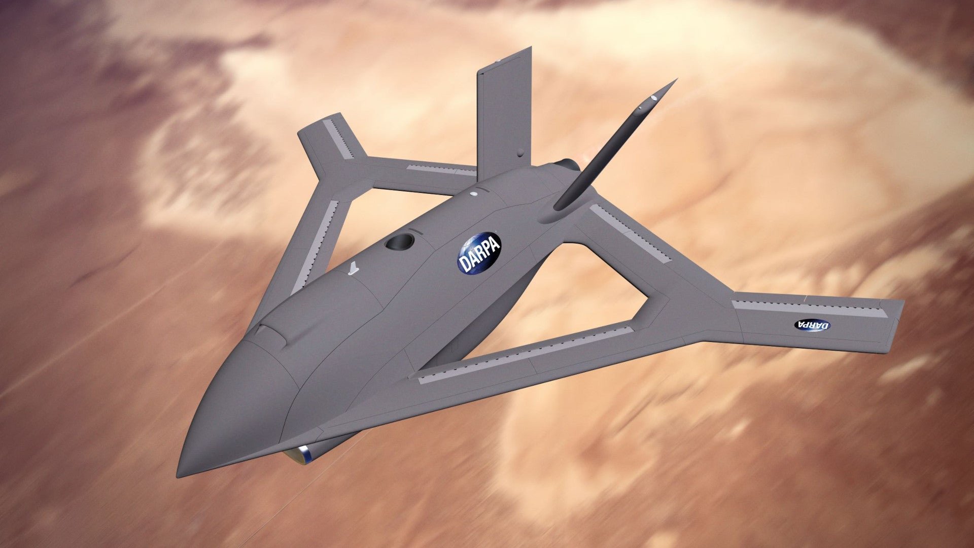

This concept image shows the planned configuration of the new full-scale, uncrewed X-plane demonstrator that Aurora Flight Sciences is currently developing for DARPA's CRANE programme.
This concept image shows the planned configuration of the new full-scale, uncrewed X-plane demonstrator that Aurora Flight Sciences is currently developing for DARPA's CRANE programme. DARPA

Having now progressed to Phase 2 of the CRANE programme, Aurora – in coordination with its parent company, Boeing, and DARPA – will now focus on the detailed design and development of relevant flight software and controls for a new full-scale, uncrewed X-plane demonstrator, which will be manufactured in Phase 3 of the project – which is currently an executable option as part of this latest contract – before it is flown and assessed in a critical design review. Aurora has already launched the detailed engineering design process for this new demonstrator, which will boast a gross weight of 7,000lb (3,175kg) and a 30ft (9.1m) wingspan.

According to Aurora, the purpose-built testbed will be designed around an AFC system that supplies pressurised air to AFC effectors embedded in all of the demonstrator’s flying surfaces. “The vehicle configuration provides AFC testing for multiple wing sweeps using nozzle arrays located at the upper surface of each wing,” the firm added. It will also feature replaceable outboard wings and swappable AFC effectors, which enables the platform to trial not only Aurora’s AFC effectors, but also the AFC effectors of a variety of other designs.
