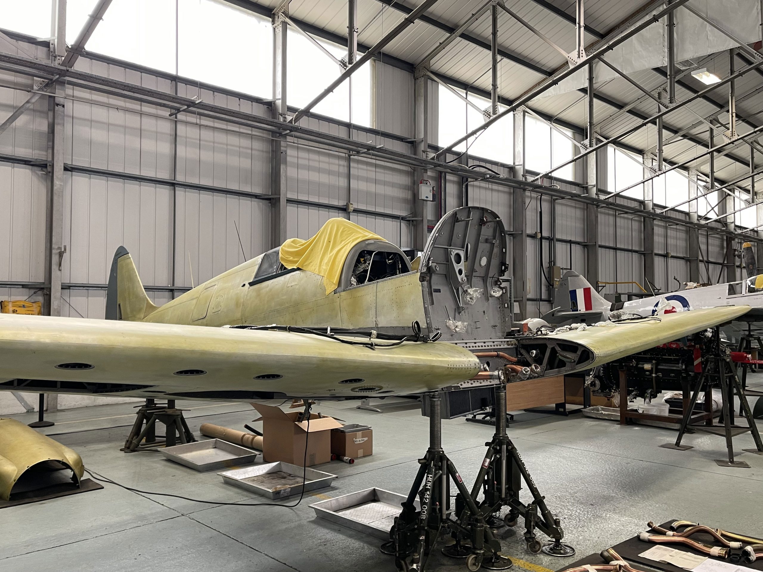

A deeper level of work is under way to bring the unit’s two Spitfire PRXIXs back on line, but PS915 is expected to return to airshow duties at the tail end of the 2023 season. PS915, which has not flown for five years, is having work done to the rear of the fuselage frame 5 bulkhead by engineers from No 71 IR (Inspection & Repair) Squadron, which is based at RAF Wittering. They hope to have it completed by the end of June. Stablemate PM631 is undergoing the first ‘major’ to be undertaken at Coningsby on a BBMF Spitfire for some considerable time, such servicing having been contracted out over recent years. It is also having frame 5 repairs carried out. When completed it will be repainted in a PRU blue scheme.

PM631, undergoing a complete rebuild by BBMF engineers, will be a longer-term returnee to the skies.
PM631, undergoing a complete rebuild by BBMF engineers, will be a longer-term returnee to the skies. TONY HARMSWORTH
