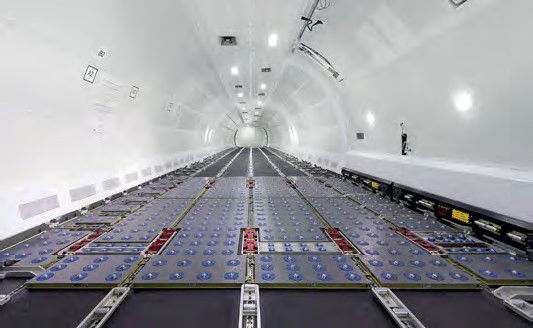

The AEI-converted 737-800SF offers a main deck payload of up to 52,700lb (23,904kg) and 2,000 nautical miles (3,750km) range. The conversion incorporates 11 full-height (88 x 125in/2.2 x 3.1m) container positions, plus an additional position for an AEP/ AEH. It incorporates a reinforced floor, a large 86 x 137in (2.1 x 3.4m) main cargo door with a single vent door system and a flexible Ancra Cargo Loading System, a rigid 9g barrier, up to five supernumerary seats, a galley and full lavatory. AEI says its conversion provides operators with an ability to open new markets carrying express cargo on short-haul routes while offering newer technology, lower fuel consumption and better reliability than standard-body freighters.
