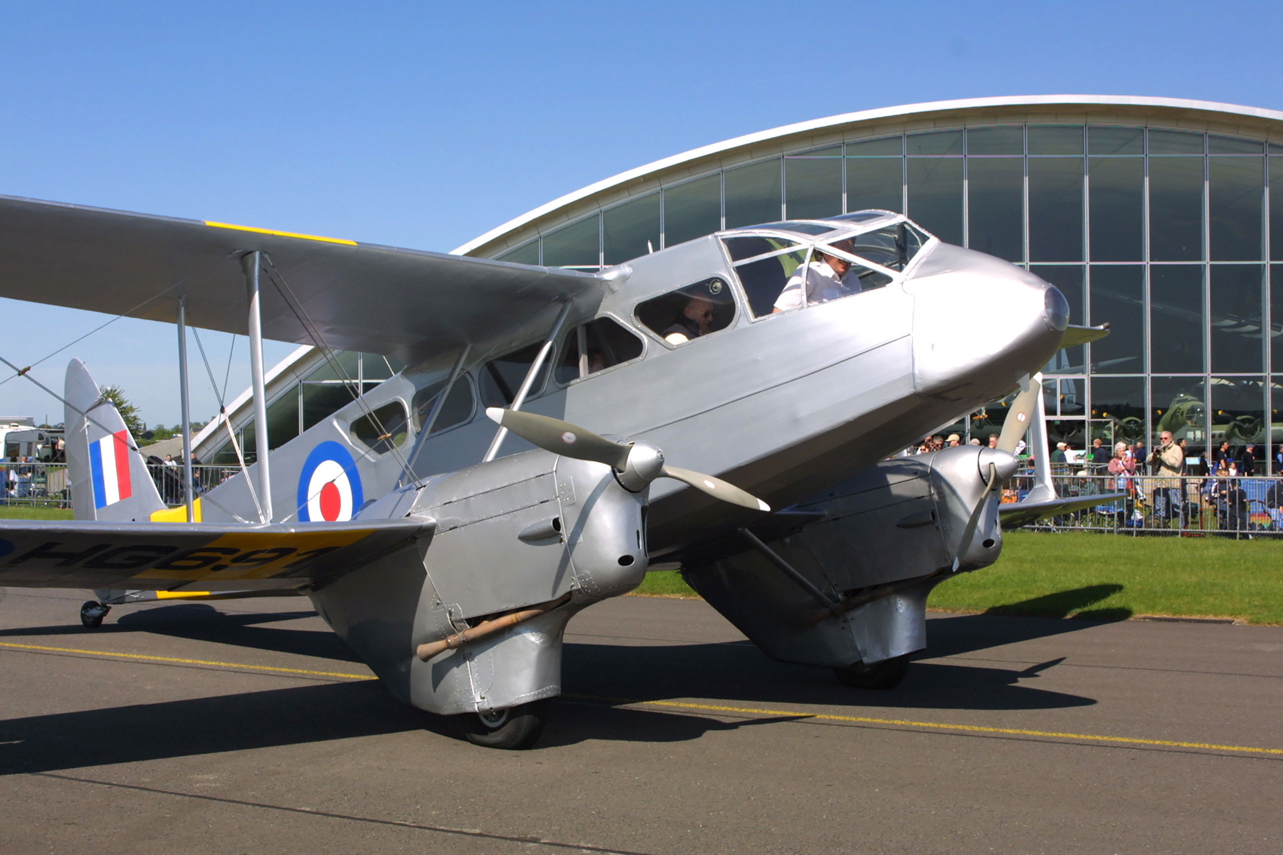

Seen here in 2003, Classic Wings’ de Havilland Dragon Rapide HG691 (G-AIYR) is a welcome and familiar sight at Duxford events
Seen here in 2003, Classic Wings’ de Havilland Dragon Rapide HG691 (G-AIYR) is a welcome and familiar sight at Duxford events Key Collection
