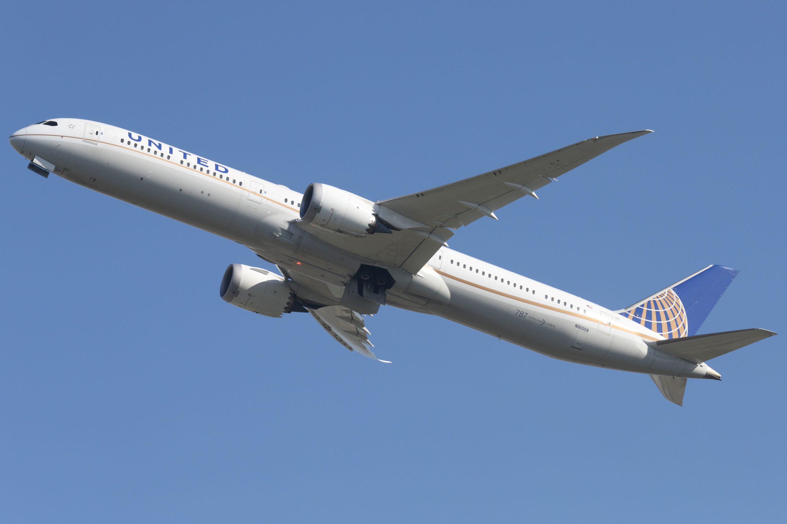

Dreamliner
The 787-10, seen here departing Heathrow in March 2021, was first delivered to United in April 2019. Aviation Image Network/Simon Gregory
