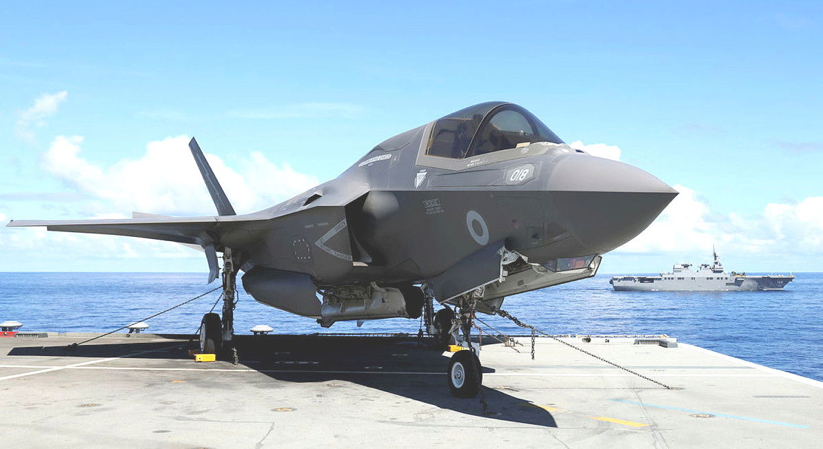

RAF F-35B on HMS Queen Elizabeth
Lockheed Martin F-35B Lightning II ZM152 ‘018’ operated by 617 ‘Dambusters’ Squadron on board HMS Queen Elizabeth on August 24 2021. This was the aircraft which crashed on November 17, 2021 MOD Crown Copyright/LPhot Unaisi Luke
