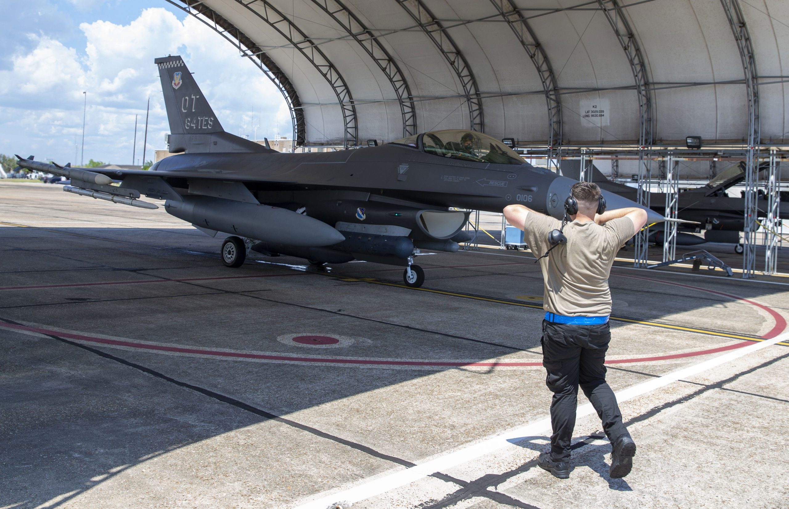

84th TES F-16C taxis before flight test at Eglin AFB 14-06-21 [USAF/Tech Sgt John Raven]
Lt Col Zachary Probst taxis an 84th TES F-16C Block 50 Fighting Falcon out of an hardened aircraft shelter at Eglin AFB, Florida, prior to a test flight on June 14, 2021. USAF/Tech Sgt John Raven
