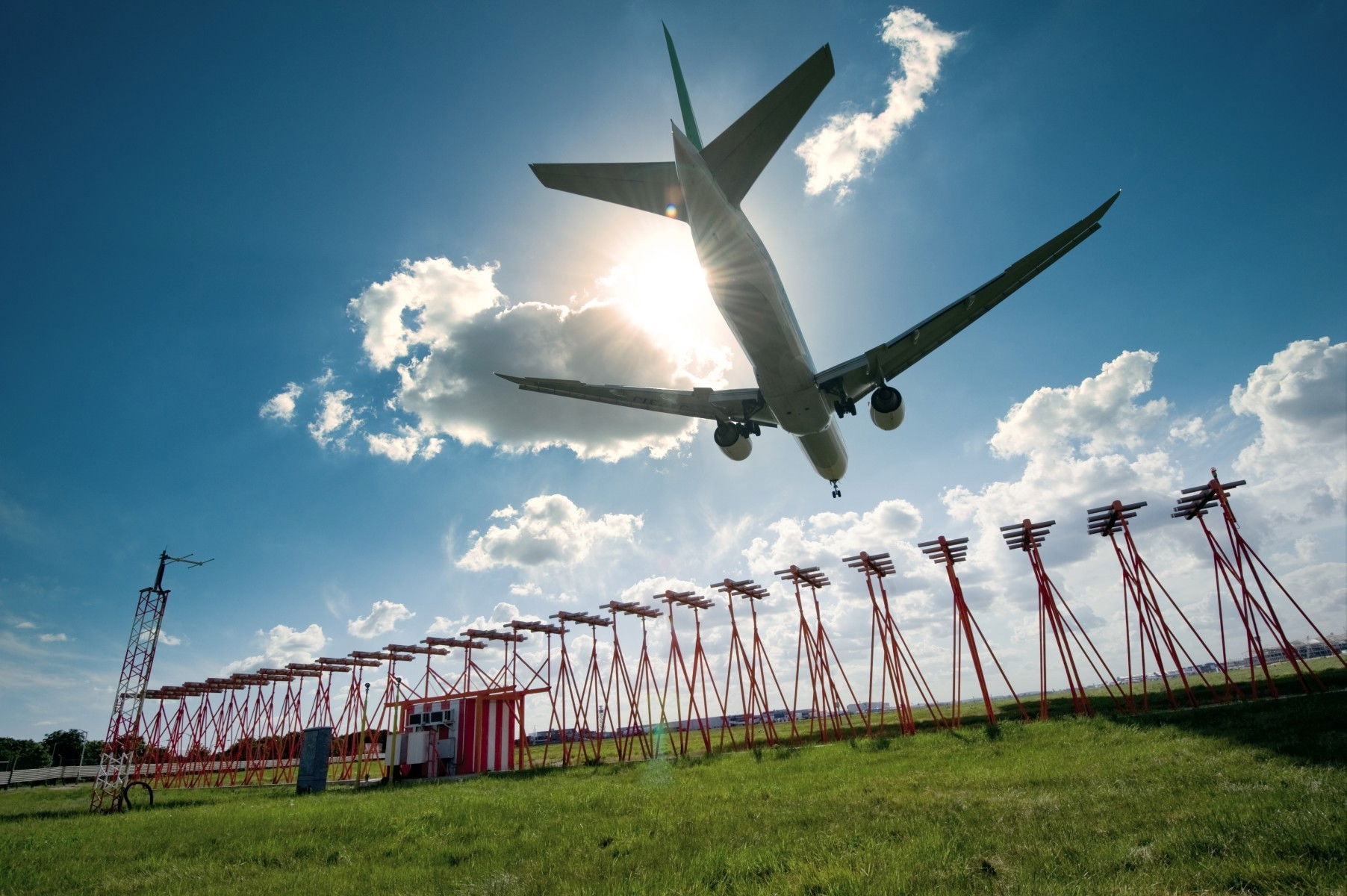

Heathrow Airport was the worst affected airport, followed by Gatwick and Manchester.
Heathrow Airport was the worst affected airport, followed by Gatwick and Manchester. Heathrow Airport
