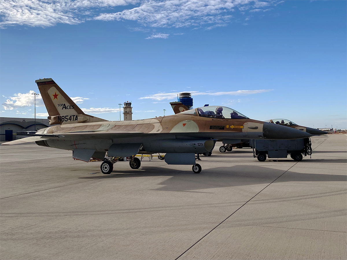

Registration N854TA, former Israeli Air Force F-16 ready to go on the ramp at Phoenix- Mesa Gateway Airport, Arizona. Top Aces
