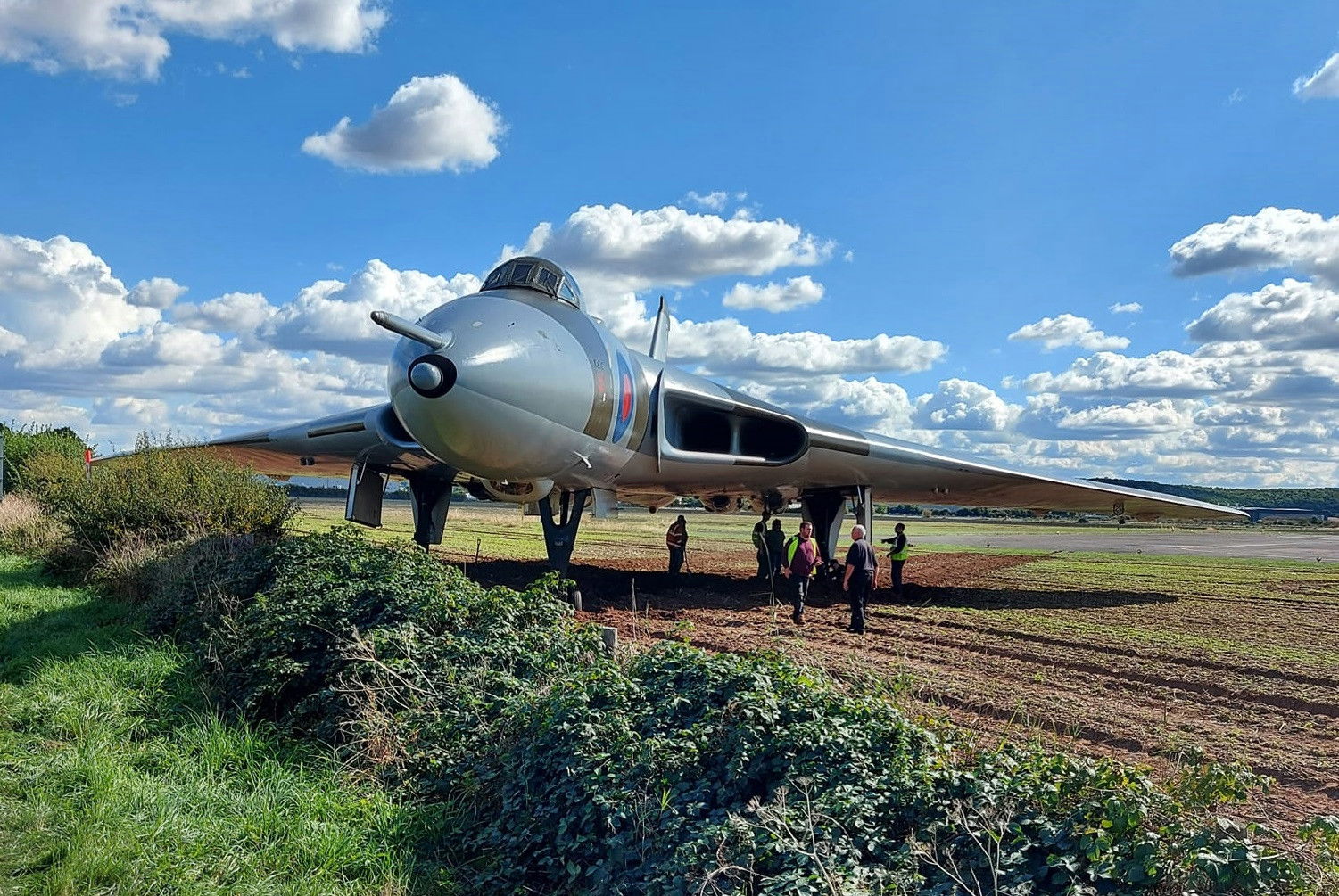

It was reported on September 16, that Avro Vulcan B.2 XM655 had exited the runway at its Wellesbourne Mountford Airfield home while undertaking a fast taxi in preparation for an upcoming public event at the Warwickshire airfield.

"It was all going to plan on Friday and the aircraft was towed to the inactive runway for crew training. The start went well and our only hiccup was the loss of power during the early checks. We think this was probably due to the ground power connector not being fully engaged in the ground power socket so a quick reseat resolved the issue and normal service resumed. The crew then went on to a series of turns and figure of eight manoeuvres within the confines of the inactive area before making their decision to carry out their practice fast taxi as part of their return journey to the pan.
"Unfortunately, the ASI normally used to ascertain the aircraft speed is the one fitted in the P2 position, so with P1 in the driving seat the P2 would call the speed. The ASI appears to have stuck, hence no feedback to P1. There isn’t much time to work things out once the Vulcan is rolling and by the time the P1 realised he wasn’t getting any info the close down of the throttles was a few seconds late. It doesn’t sound much but it was enough that the aircraft was carrying too much speed at the normal turn off point. She departed the runway and came to rest next to the hedge at the airfield perimeter and just before the Stratford road.
"It looks as if the soil conditions were perfect for slowing her down and although she plowed 3 furrows across the field she was brought to rest with no injuries to the crew or anyone else and they all departed the aircraft with no external assistance. It took a lot of digging and a lot of pulling on Saturday but early in the evening she was safely returned to the pan where we will begin a series of inspections to establish the condition of everything. Initial visual inspections look good but we will need to carry out a lot more checks yet before we can be certain.
