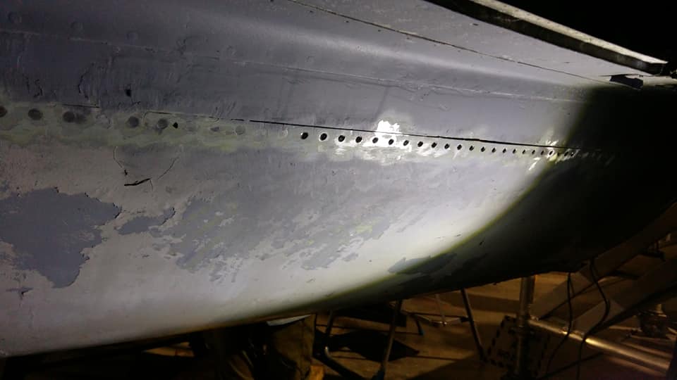

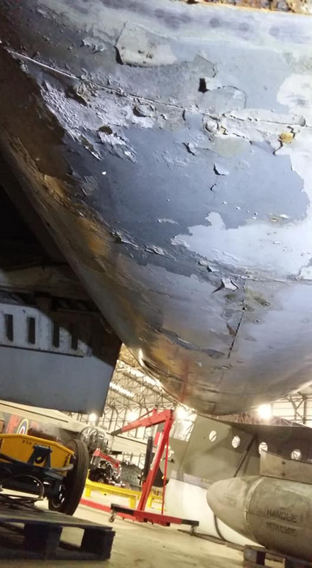

The undersides of the wings around the airbrakes area are the worst bits of the jet so far, a legacy of years of East Coast weather I suspect
http://i819.photobucket.com/albums/zz117/Blue2MGB/Meteor/20151127_111618_zpsk1h9thnd.jpg
http://i819.photobucket.com/albums/zz117/Blue2MGB/Meteor/20151127_111634_zpssbmkhtsi.jpg

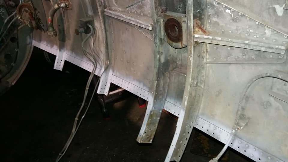

peering into the aircraft’s inner structure was encouraging though. A bit of flaky paint and lots of muck, but nothing terrible and certainly little in the way of corrosion.
http://i819.photobucket.com/albums/zz117/Blue2MGB/Meteor/20151127_111702_zpscbe8fdpz.jpg

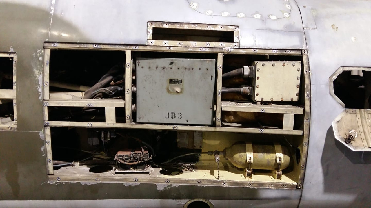

The bay itself looked better than I anticipated too, with the battery leads in place still and even a couple of tools left for us courtesy of the RAF!
http://i819.photobucket.com/albums/zz117/Blue2MGB/Meteor/20151129_114055_zps0y5y28bh.jpg

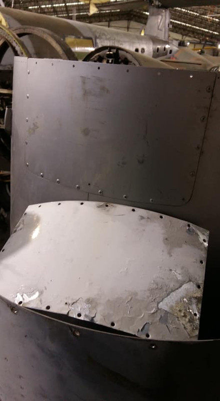

18/11/19 Update
Well it was never going to go that smoothly Malcolm; fitting new metal to a hand-built British jet never does! I borrowed Danni and Eloise to help me, as well as a couple of ratchet straps to hoist the panel into place and support it while we aligned it. Suffice to say, we were a bit busy for taking too many photos! Getting it hoisted and aligned was satisfying.
https://i.postimg.cc/6QPYfZwm/75323347-2442387359366625-3432509395919962112-n.jpg
https://i.postimg.cc/k4tw15gX/75464281-2442387316033296-4505183370791092224-n.jpg
Then began the riveting. Which, once we had got enough rivets in to hold the panel, stopped.
https://i.postimg.cc/D0k6tKSQ/76648989-2442387276033300-2256492817075404800-n.jpg
Why? because a visitor went running to the office to complain we were making too much noise. An air riveter, in an aircraft hangar, making noise where an aircraft is being restored? Who would have thought it eh? Some people are only happy when they are complaining. In fairness the office were fully supportive of us, but it soured our day. So we did just what we had to do to secure the panel, then thoroughly fed up sacked it off and went to the pub instead. You wonder why we bother…
The new panel has improved the look of the engine nacelle greatly though…

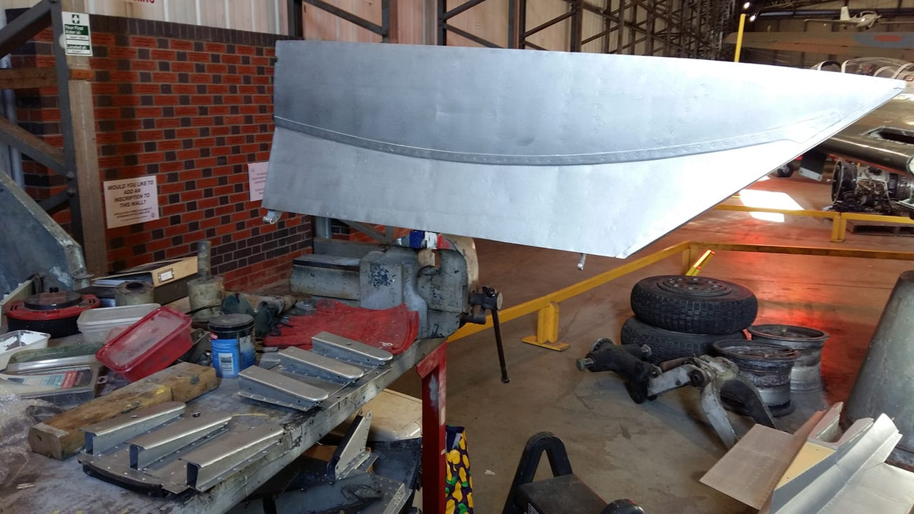

16/11/2019 Update(let)
Not the most productive day, as work had to stop due to lack of bodies to lift the new panel in! Much of the work today was drilling out the remains of the rivets, preparing the new panel to go on, and getting everything ready for lifting the panel into position tomorrow really.
All the holes cleared and ready to go. She does look rather naked!
https://i.postimg.cc/qvdmSJd1/74270774-2441289359476425-4582014851043295232-n.jpg
Panel prepared, and lined up ready to simply lift into position (!) tomorrow…

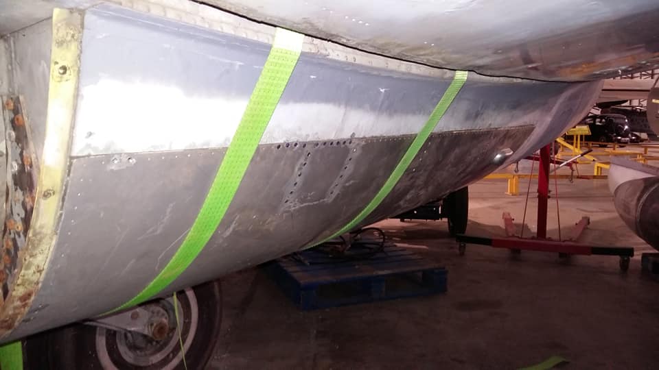

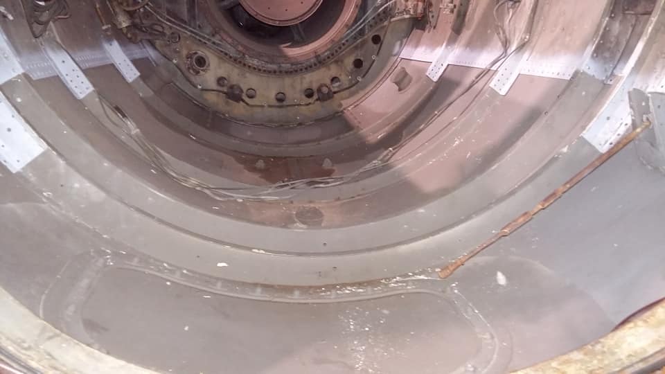

12/11/2019 Update
Well I tried to respond this morning Malcolm, but it appears the forum had yet another rush of sh*t to the brain. Still, it seems to be working now. It was a very wintery bonus day in the hangar today; with this in mind Eloise and I fortified ourselves with cookies as well as Jaffa Cakes!
https://i.postimg.cc/YS9Kwst4/74809475-2437256329879728-1177584989231906816-n.jpg

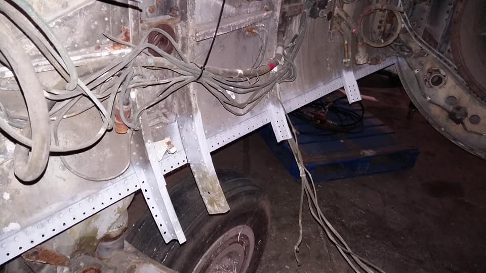

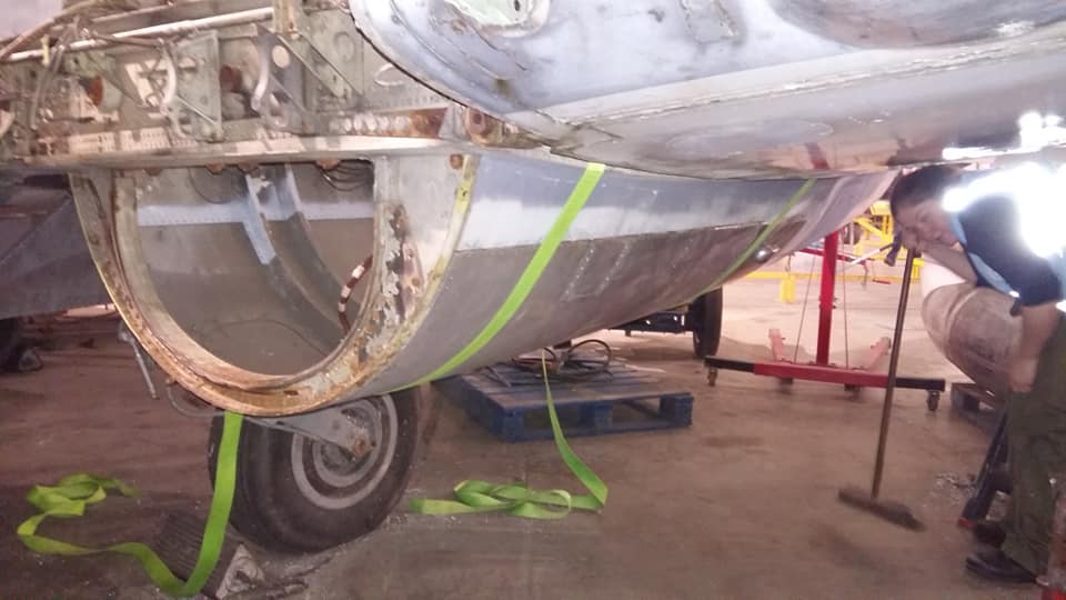

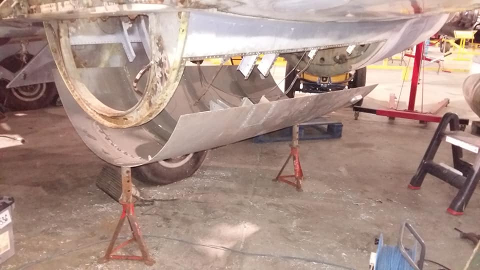

Today, we decided to make a start on removing the port lower engine nacelle skin, prior to fitting the first of the pair of shiny new examples sent our way by East Midlands Aeropark. To ease access, the port main undercarriage door had to be taken back off first
https://i.postimg.cc/DzMVfPzx/73316089-2437256249879736-5733354270086922240-n.jpg

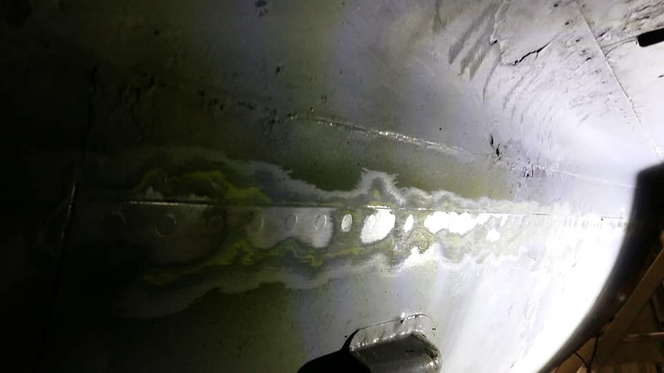

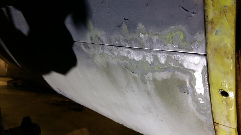

This duly done, we then started in with the fibre wheels on the rivet lines, to reveal the rivets requiring drilling out
https://i.postimg.cc/3J5TD1F6/74883036-2437314793207215-4135755340828377088-n.jpg
I soon had most of the inboard side of the nacelle cleared…
https://i.postimg.cc/261DnXJp/75398114-2437315229873838-3724734516858716160-n.jpg

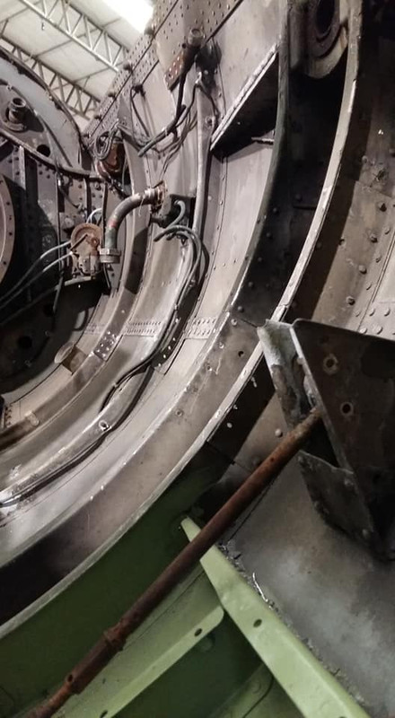

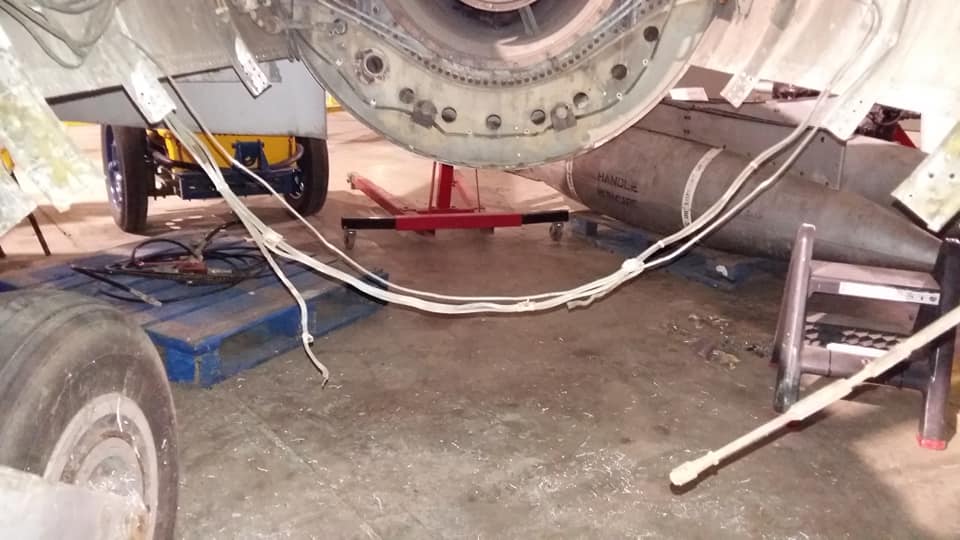

So while Eloise finished the outboard side I hopped into the nacelle to commence the attack on the rib rivets
https://i.postimg.cc/cLTy2SGy/75627487-2437354569869904-8841187855238692864-n.jpg
Eloise soon had her side done. I was still working in the nacelle so, rather than have her start drilling rivets out of the nacelle and potentially holes in me, she went and began rivet chasing on the other nacelle. She got a good bit of it done too, before I called her back as I was ready for the rivet removal to commence!
https://i.postimg.cc/7PT46d00/72667844-2437354719869889-1133140723487473664-n.jpg
This gives us a head start on the starboard nacelle. And so, the drill-athon began…
https://i.postimg.cc/TP7xLXtq/75246576-2437444116527616-2966033650736431104-n.jpg

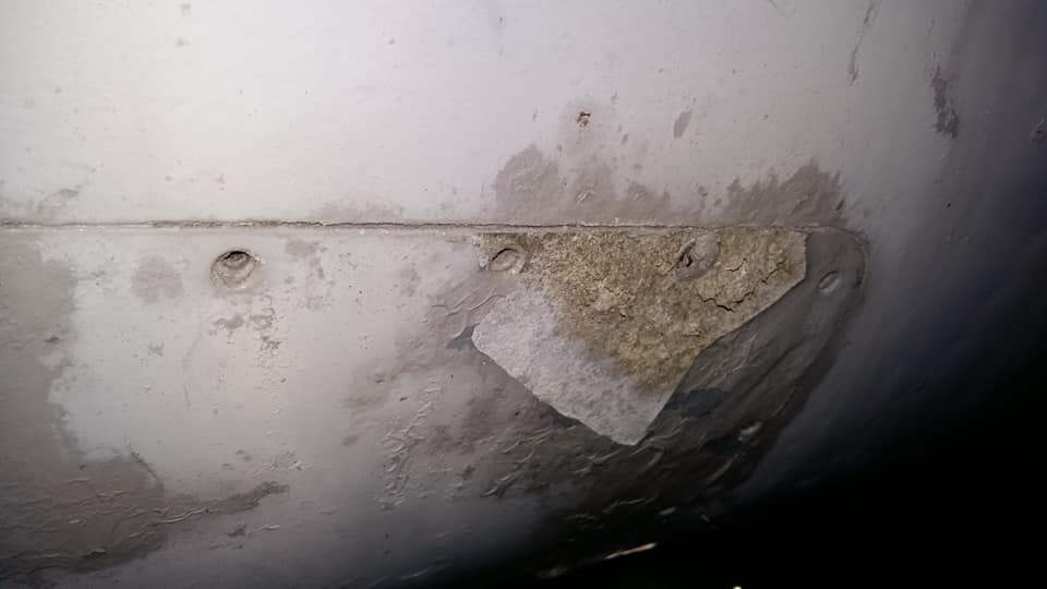

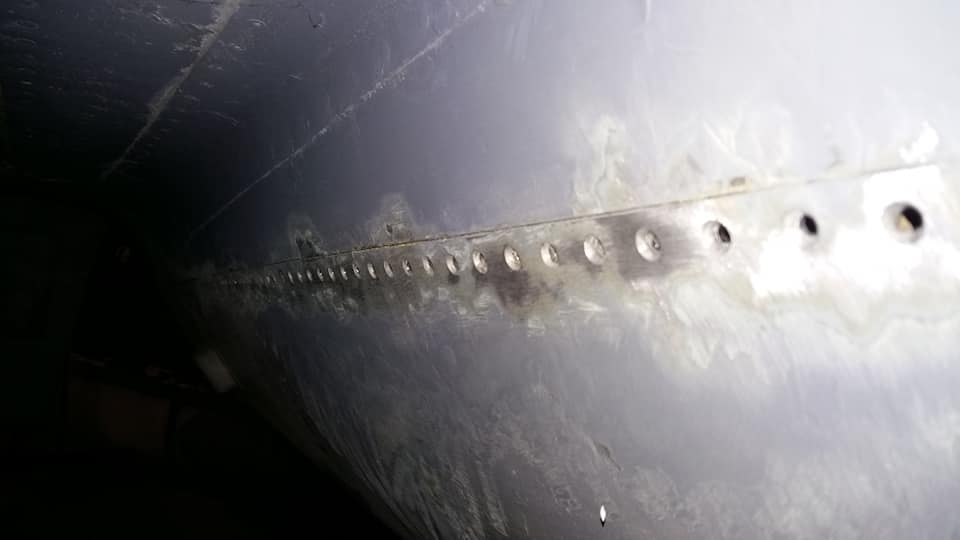

Not the most exciting of things to look at, a row of holes! While I was down there I took a couple of pictures to show you all just why we need to do this work, and why the new lower nacelles are such a godsend…
https://i.postimg.cc/XYn6svhk/75380547-2437316919873669-4891014237339516928-n.jpg
https://i.postimg.cc/2yvNKLr2/74595038-2437316796540348-9122430323894779904-n.jpg
It ain’t pretty, is it?!

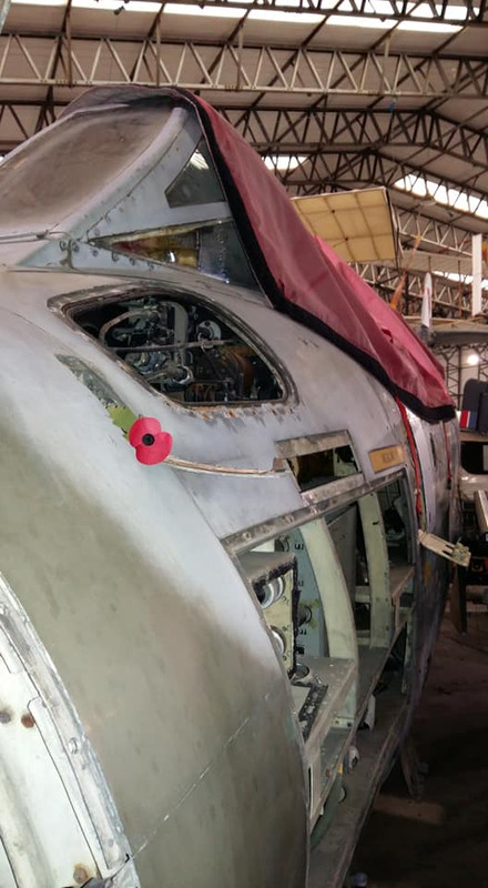

11/11/2019 Update
…As I’m sure you can appreciate, given the fact that it was Remembrance Sunday yesterday, not very much engineering happened. It was one of those days that was more about the people than the aircraft, and rightly so. Given the museum’s French connections, this took an unexpected turn later in the day for us on the Meteor team too; more on that later. But first, seeing as it was sunny, and the Meteor 8 has moved round to outside our side of the hangar, I decided to open her canopy to give her cockpit a few hours’ airing out.
https://i.postimg.cc/ydtZMXhB/74687734-2435444590060902-9071508418539290624-n.jpg
I thought seeing as this was a day for reflection, this shot seemed very appropriate. The number of crew killed flying these first generation jets, the Meteor, Vampire, Venom etc, as the RAF took its first steps into the Brave New World of jet operations are quite staggering.
https://i.postimg.cc/0Ntmfqbz/75497628-2435444540060907-405946393123880960-n.jpg
A part of why we do what we do is for those chaps, who were then flying at the cutting edge of British aviation. It tends to be overlooked these days, just what a dicey business operating the early jets could be…
