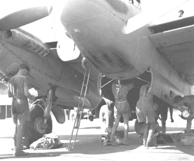

From the early ’40s to the middle ’50s, the standard RAF fighter armament was 4x20mm Hispano cannon, as in this Mosquito NF36

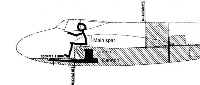

Incidentally in the Mosquito the guns recoiled against a semi bulkhead immediately below the cockpit floor, so if the nav kept his feet on the floor he could feel the recoil strongly, see diagram below
