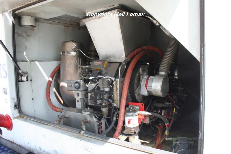

For many years BA used air starters for any type needing it as well as Concorde as it has no apu fitted,the air starters were nicknamed Trident Transit’s as they had the Garret apu’s on the back and boxed in,all the apu’s were removed from retired Trident’s ,here is a photo of one the units.
http://i136.photobucket.com/albums/q193/Neil2312/trident_transit.jpg
