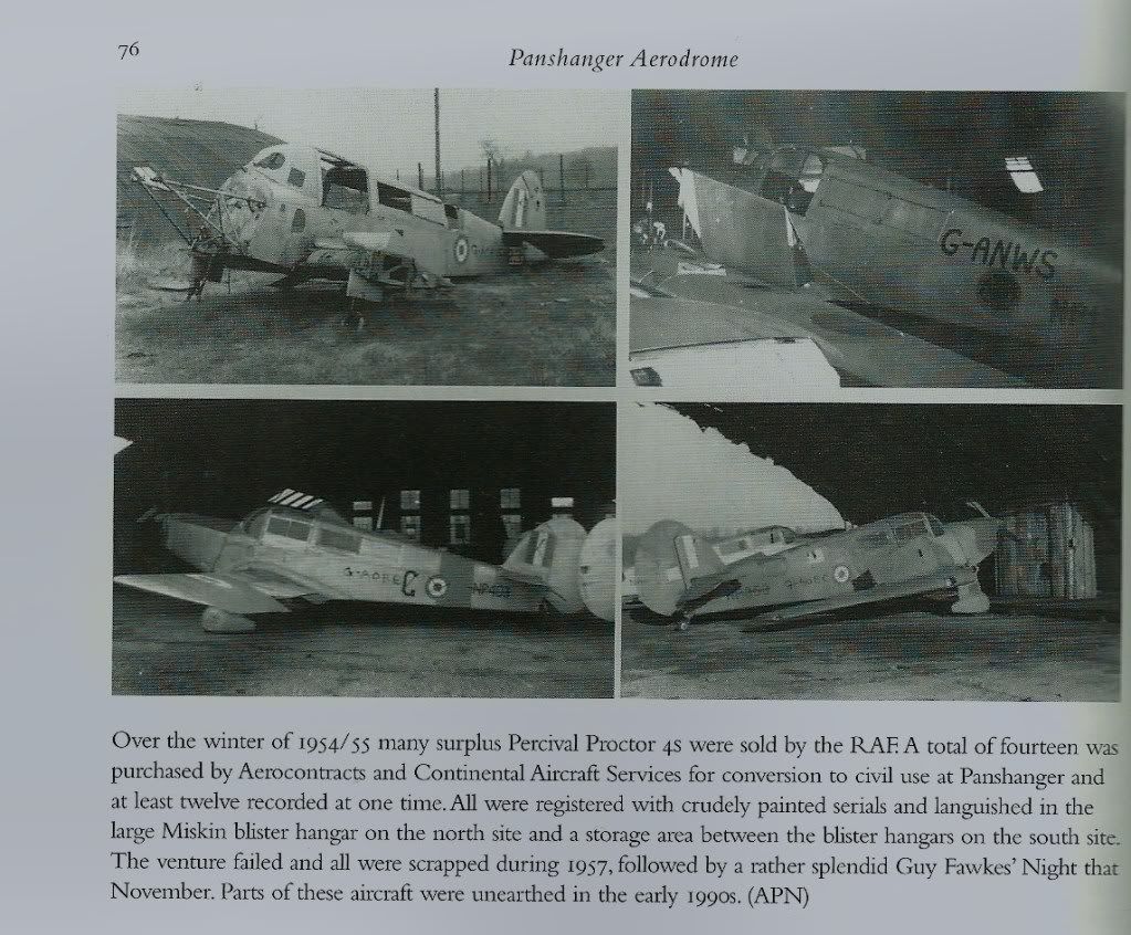

There are many many references to Prentice and Proctor aircraft in the book, are you sure it was Airwork ? as the only major mention of them is as a very early Cessna dealer at Panshanger in the T2 hanger ??
Meanwhile there are several mentions of Proctors in large numbers with “Aerocontracts and Continental Aircraft Services” and a lot broken up and burnt …… see scan below ……. Keith.

Keith, does that book also contain any info on what happened to the Airwork Prentice and Proctors dismantled in an old hanger on the N side of the field in the mid-late 50s?
I am up with the excellent Proctor restoration work at Gt.Oakley, but it seems the airframes were not the actual ones stored at Panshanger, so I still don’t know what happened to them.
Also broken up I expect.
