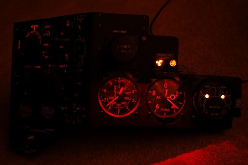

This is the bit I like, getting the panel lit!
http://i9.photobucket.com/albums/a82/pagen/Sea%20Vixen%20Simulator%20Small/l007s.jpg
…and with the IFR valve lights shining

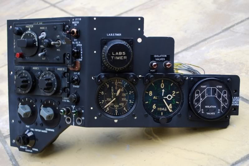

5,170
By: Wyvernfan - 9th August 2011 at 21:15
Impressive work James, that has come up looking like new :).
Just out of curiosity what letraset did you use and where are they available from?
9,672
By: pagen01 - 9th August 2011 at 21:10

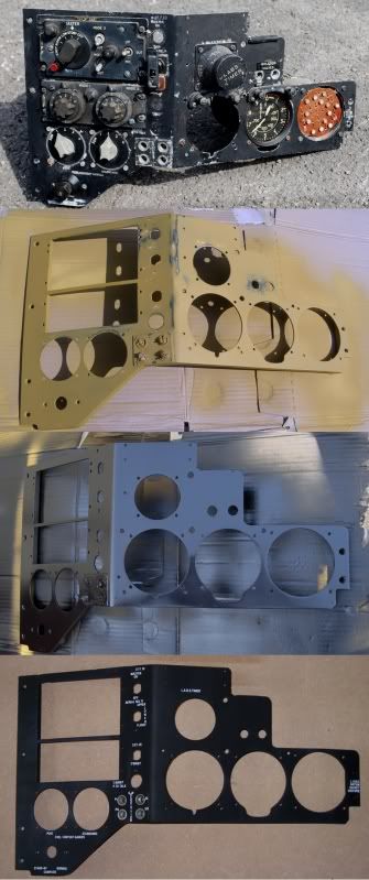

Just finished restoring this Sea Vixen FAW.1 observers forward (AN) panel.
It was surprising how corrosion had taken hold causing deep pitting, especially around instrument holes, fittings, and the lettering.
The panel was completely stripped, and then corrosion stopper, filler, filler primer was applied and rubbed down before the satin black coat applied.
Photos were taken so that the wording could be reapplied, this was helped by slight depressions in the panel that indicated where the lettering went exactly.
Letraset was used, although it is the correct height and width lettering, it is slightly more bold than it should be, a final satin clear coat was applied over the panel and lettering.
All instruments and switches were completey cleaned up, missing items and new screws sourced, thanks to DH112 and JonH for their invaluable help.
I could still do with finding two green lamps which are missing in the GW Acquisition panel.
http://i9.photobucket.com/albums/a82/pagen/Sea%20Vixen%20Simulator%20Small/panelr1.jpg
http://i9.photobucket.com/albums/a82/pagen/Sea%20Vixen%20Simulator%20Small/p004s.jpg
I am in the process of doing the same for the observers stbd side (N) panel, and the pilots main (B) panel.
