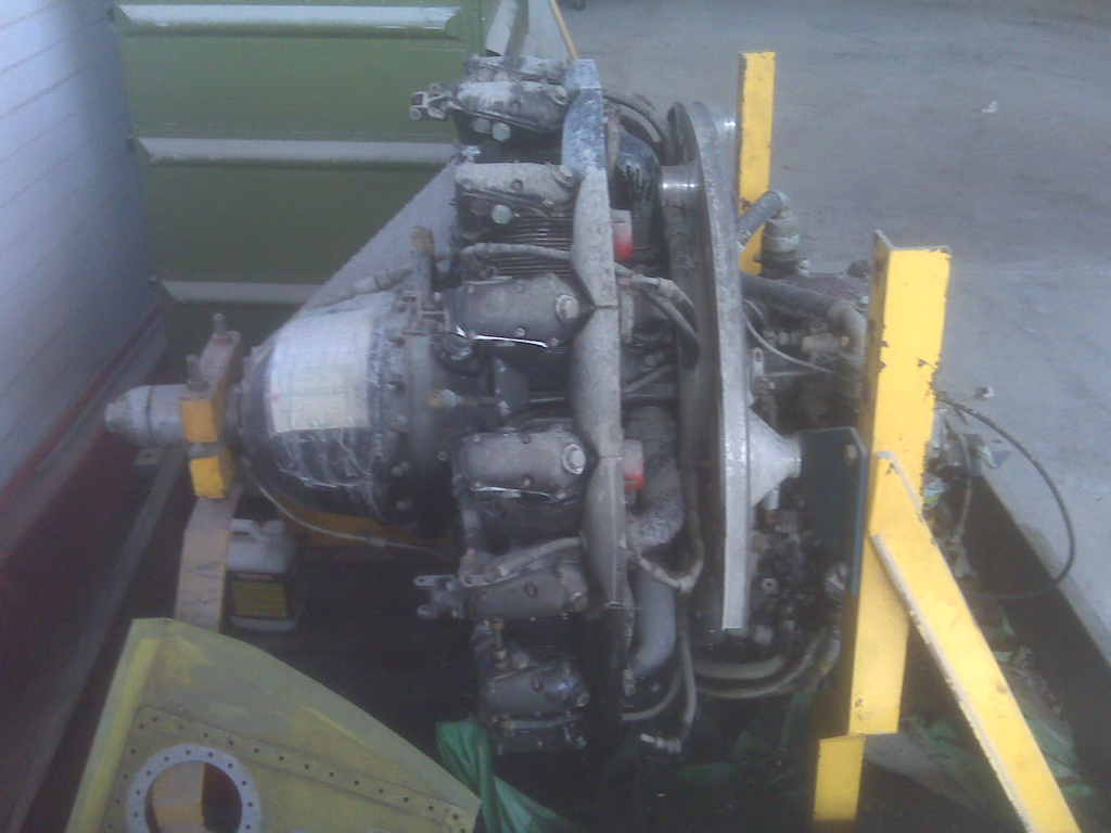

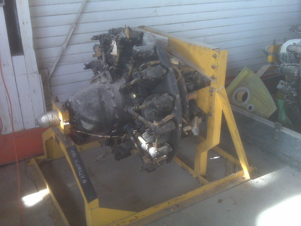

Some odd things found here in the USA, and in the interest of world peace, trying to find a good home for them. First off, two Alvis Leonides Engines with no paperwork other than a tag atop one that says, “Runs rich” but “inhibited 1987” and the other one with no tag at all. Both have been in this hangar for twenty years, and are ready to ship. These appear to be operable spares and are fairly complete. Any trades would be considered…but I prefer trubine engines of the Nene or Avon variety…so these could be a partial trade. A sale is preferred, but if not, I can make tables with them…and maintain them that way. They are very interesting powerplants, very compact for the power they produce. A shame they were not on the T-6/SNJ at some point…. Is there any use for these? Ships from Nevada, USA…
http://i117.photobucket.com/albums/o55/internationalblue/Alvis1_zps122c1dc2.png
http://i117.photobucket.com/albums/o55/internationalblue/Alvis2_zps399ea04b.png

we are looking for engine parts for our Leonides-powered Percival Pembroke (we are running a collection of old British aircraft here). You might have something that will get us out of trouble…..BUT…..there were two sizes of Leonides. We need the smaller one. One way to tell is to count the number of fins on the cylinders (ie the barrel portion, ignoring the cylinder head). The smaller engine has 9 fins; the larger has 13 fins. I can’t make out from the photos which one you have. Of course, you might still have the makers plate on the case near the CSU mounting. The smaller engine is likely to be a 502 or 503. If it says 531 or Mk138 it is a larger engine. There was only about 1/2″ difference in stroke, but none of the parts seem to be common!
all the best, Steve Evans

The engines are For Sale, and shipping to the UK will be something I can take care of, doing the legwork and all, but the buyer will have to pay the trucking. I recommend shipping by truck to port of Oakland, then container, or pallet in a container to a UK port. I would like $2,500 USD each, but am open to offers.
