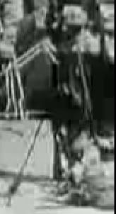

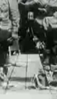

By: SamKimpton - 12th April 2007 at 09:42
It sounds very much like what you are describing is the ubiquitous “Holophane light” as used by pathfinders for marking drop zones in Normandy. No numerical designation appears on paper for this item that I know of.
everything you describe is congurent with this peice of equipment save for the 1942 date. It was not modified from an existing item but rather was developed specifically for marking drop zones and navigational waypoints and was not delivered until late April or May of 1944.
This is why the 1942 date you mention confuses me.
These lights were supplied to both US and British Pathfinders by the Air Ministry so this marking is correct as well.
I do not know about the leveling bubbles you mention. These do not seem to appear in period imagery I have seen.
the single threaded hole at the base of the lamp body is for mounting to the tripod. In American use this would be the LG-21 type as used with the M-227 signal lantern. I have seen a photograph from the immediate post war period of one of these in British use in Greece on a wooden tripod as well.
Take a look at these frame grabs from Signal Corps Footage of Lt Gene Williams’ Pathfinder team (508th PIR) North Withham, UK (May 1944)
http://i14.photobucket.com/albums/a311/Skytroop/Holophane%20Light/untitled5a.jpg
http://i14.photobucket.com/albums/a311/Skytroop/Holophane%20Light/untitled5.jpg
A clearer image of the light may be seen in Gary Howard (2005) “America’s Finest II”
Unfortunately I could not seen any image or images of the light you describe. I am very interested if you could post them again or otherwise provide a link to them.
Sam Kimpton
Pathfinder Studies Group
http://groups.yahoo.com/group/Pathfinder_studies/
