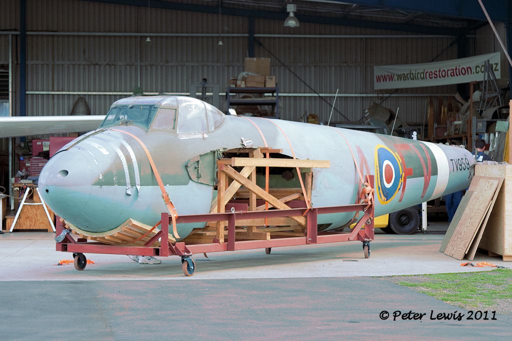

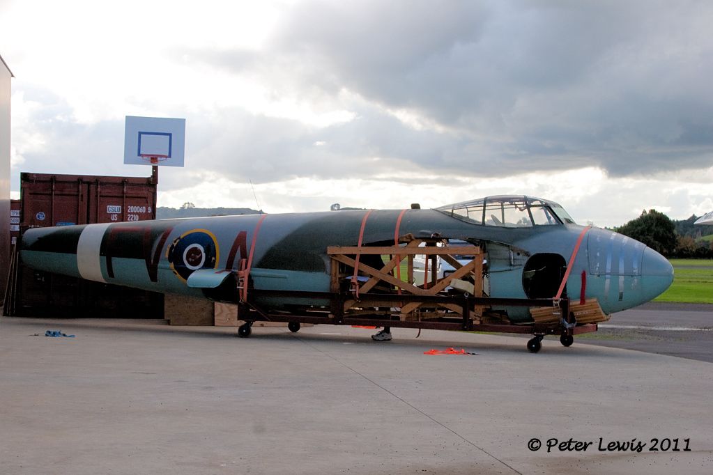

Seen today sitting outside at Avspecs, Ardmore
http://i104.photobucket.com/albums/m169/flyernzl/aircraft/TV959_IMG_9928-Edit.jpg
http://i104.photobucket.com/albums/m169/flyernzl/aircraft/TV959_IMG_9931-Edit.jpg
According to the usual internet sources:
Mosquito T.III TV959. Accepted: July 1945, Assigned: 29 August 1945 No 13 OTU (KQ RAF type C roundel.svg G) (RAF Middleton, St George), Assigned: 31 October 1946 No. 266 Sqd, Assigned: 24 April 1947 No. 54 OTU (RAF Eastmore), Assigned: 17 May 1947 No. 228 OTU (RAF Leeming), Assigned: 15th July 1951 No. 204 AFS, Stored: 6 February 1952 No. 27 MU (RAF Shawbury), stored: 20 August 1953 No. 49 MU, Stored: 16 November 1954 No. 27 MU (RAF Shawbury), Assigned: 16 December 1955 HCEU / HQ’s Fighter Command Communications Squadron (RAF White Waltham), Assigned: 30 April 1959 No.3 CAACU ( RAF Roundel Y) (RAF Exeter), SOC: 31 May 1963, Movie: 633 Squadron (HT RAF type C roundel.svg P / serial MM398) , Transferred: Imperial War Museum, sold: 6 April 2003,
Currently with The Flying Heritage Collection, stored in Norfolk.
So it looks like we have another rebuild to airworthy?
