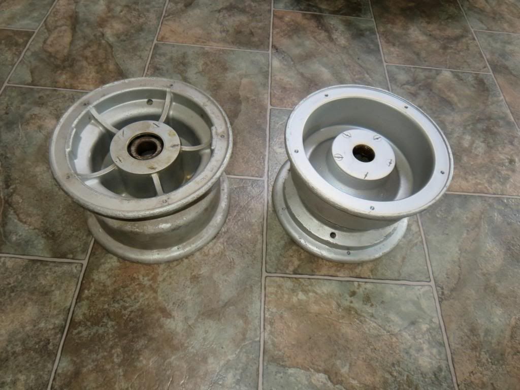

Good news and bad news today…
The good news:
A set of very nice Tiger Moth wheels turned up. Also good for Avians…. 🙂
http://i876.photobucket.com/albums/ab327/mightyauster/TigerWheels_zps636402b9.jpg

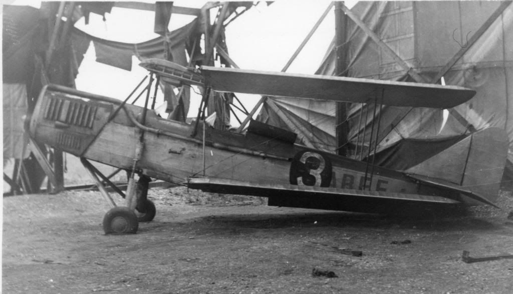

Does anyone know what colours G-ABEE wore?
I also have an earlier photo I have pinched from eBay of G-ABEE, with a different configuration for the windscreens and the main undercarriage. I am not sure if I will rebuild G-ABEE to this, or the later configuration and colour scheme.
http://i876.photobucket.com/albums/ab327/mightyauster/G-ABEE_zps6775cc83.jpg
56
By: dh83 - 28th May 2014 at 12:48
yes taken in 1955
dh.83

By: Avro Avian - 28th May 2014 at 12:20
An interesting photo dh83! Is it the same Bessoneau hangar at White Waltham?
I have a very similar photo here, presumably at the same location.
http://i876.photobucket.com/albums/ab327/mightyauster/img004_zps5d466d61.jpg

By: dh83 - 28th May 2014 at 11:20
[ATTACH=CONFIG]228733[/ATTACH]
hope this works reason for not flying
