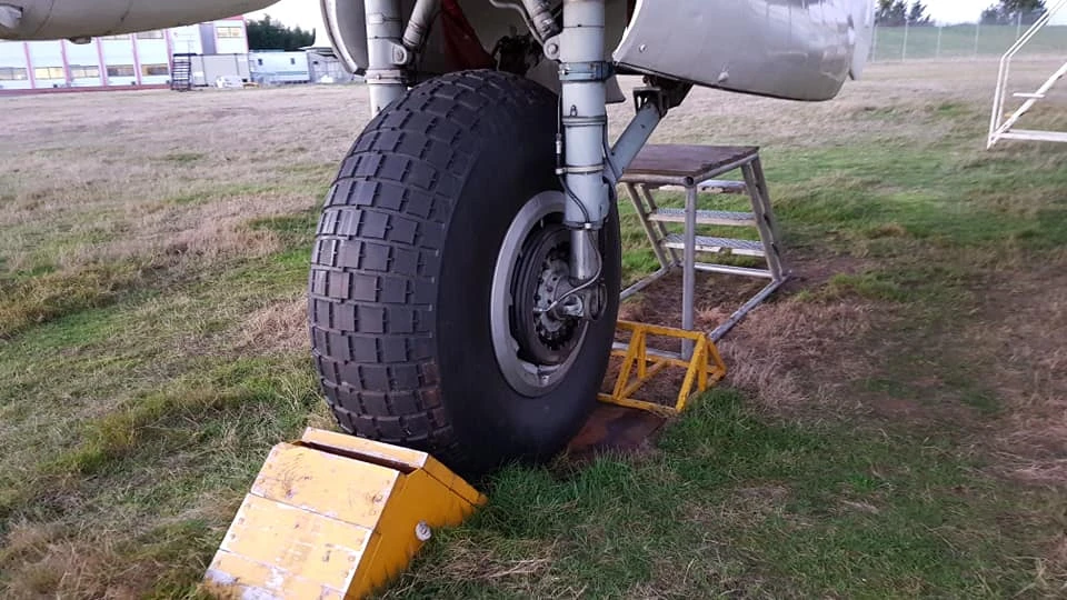

Standing Tall
After the Christmas and New Year break, i decided to use some spare time to get through to the aircraft and get some work done.
Getting there proved eventful along my 1 hr 30 min journey, breaking down en-route. Once on site i was able to change over our Nitrogen Bottles and replace them with some new full bottles. Special Thanks goes out to one of our supporters Energas for their continued support and supply of Nitrogen.
https://static.wixstatic.com/media/8c80ee_9476f37b981343b5b2be9d45272d31cb~mv2.jpg/v1/fill/w_960,h_540,al_c,q_90/8c80ee_9476f37b981343b5b2be9d45272d31cb~mv2.webp
Moving these bottles by hand on your own is one massive workout on a chilly winters day.
With the new bottles fitted to our Nitrogen Trolley, i set to work re-inflating the undercarriage legs and getting the old girl to stand proud once again. With the colder weather as with most things the legs contract, seals get looser and gas escapes. Without constant topping up its inevitable the legs will lower the aircraft. So to take into account for this expected continued change in temperature, the legs got there gas and a little more than usual.
https://static.wixstatic.com/media/8c80ee_c505fe30387e46aea7c7b4d2660e8ec6~mv2.jpg/v1/fill/w_960,h_540,al_c,q_90/8c80ee_c505fe30387e46aea7c7b4d2660e8ec6~mv2.webp
Considering the Temperature, the legs are holding pressure well and looking much healthier.
We do have a little leak, which will be monitored and rectified on the next visit. Although on initial inspection, it looks to be residue from when the legs were at their lowest position allowing fluid to slowly escape past the seals.
https://static.wixstatic.com/media/8c80ee_0f30b5c3b1c14f75b71b4bdf9acd902c~mv2.jpg/v1/fill/w_528,h_960,al_c,q_90/8c80ee_0f30b5c3b1c14f75b71b4bdf9acd902c~mv2.webp
A little bit of fluid leakage, most probably from the seal when sat at its lowest position.
Now shes all refilled, she has finally got her proud stance back. Once again looking towards the skies she will one day return to.
https://static.wixstatic.com/media/8c80ee_b0c8dec170cf4be0ac698e6f18a51a7f~mv2.jpg/v1/fill/w_960,h_540,al_c,q_90/8c80ee_b0c8dec170cf4be0ac698e6f18a51a7f~mv2.webp

On shut down we noticed a slight oil leak on number 4.
Panels off and a good route around soon found the potential cause.
https://i.imgur.com/dKC6KMZ.jpg
https://i.imgur.com/ZdUBm0w.jpg
https://i.imgur.com/sLSSe7f.jpg
https://i.imgur.com/VReBbFw.jpg
https://i.imgur.com/U7hen8N.jpg
https://i.imgur.com/WDW9Qc3.jpg
One of the oil breather catch tanks had become blocked which seemingly forced pressure back up the system to find a path of least resistance. This happened to be an area around the rocker cover where a securing nut had been left undone on the last engine overhaul.
This allowed the smallest of gaps to form and sprayed a fine mist of oil into the engine panels. Slowly pooling until reaching a ledge it could escape from.
From the amount of oil that was found it has been continuing for some time on and off. Layers of old oil had been found in the deepest of corners of the front panels.
As it was not possible to notice when carrying out the regular cleaning of the filters. It would only have been found if we had decided to remove all engine panels encasing the engine. Until that point, no-one would have known until our findings today. Top top it off oil consumption wouldn’t have let us know as it was keeping with what we expect for our operations.
Needless to say, the breather has been removed for a full clean and flush through, the loose nuts tightened with others checked and all panels removed, cleaned and replaced.
