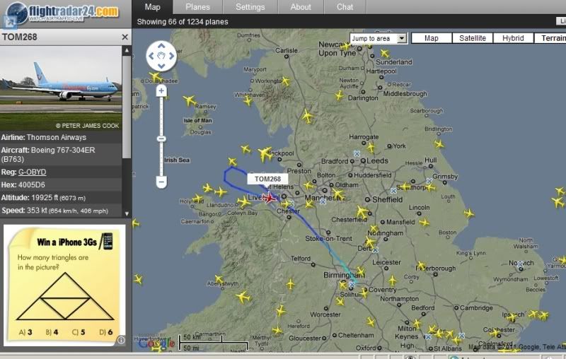

…and now on flightradar I’m seeing G-OBYD turning back to the UK after heading towards Cancun, not sure why yet!?
http://img.photobucket.com/albums/v693/skylinerworld/TOMTurnaround.jpg
Update: Now circling by the coast – presuming it’ll be dumping fuel.
