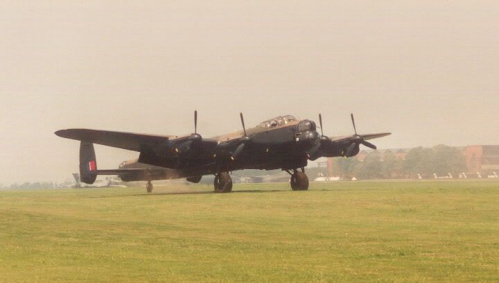

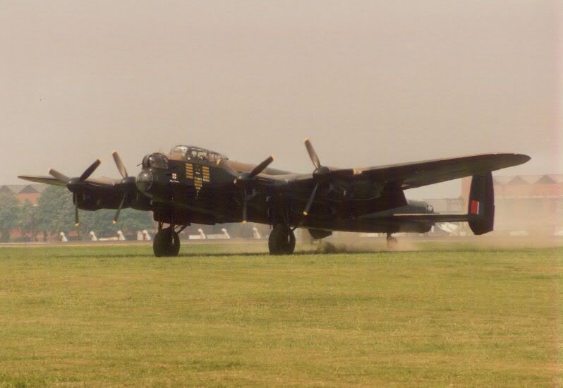

By: kodak - 15th April 2008 at 15:47
An almost carbon copy of the Mildenhall ’92 event. I was in the press area at the time and so the Lanc was heading for us rather than the crowd in that instance. Quite hairy! I bet that JR pilot had a shock at N Weald when he turned to seeing that filling his screen!
Didnt get the actual turn in bit this is a few seconds later-
http://img.photobucket.com/albums/v147/AEROMEDIA/warbirds/lanc92mishap.jpg
Turned almost on itslef to come to rest…
http://img.photobucket.com/albums/v147/AEROMEDIA/warbirds/Scan137-1.jpg

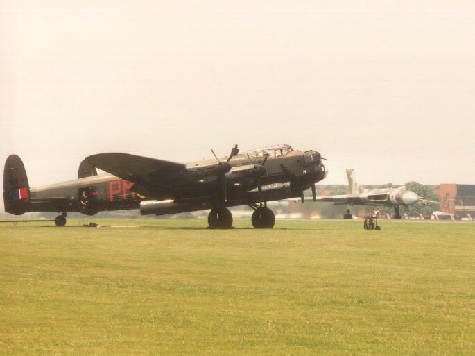

It stayed there and made possible this interesting combo!….
http://img.photobucket.com/albums/v147/AEROMEDIA/warbirds/Scan138-1.jpg

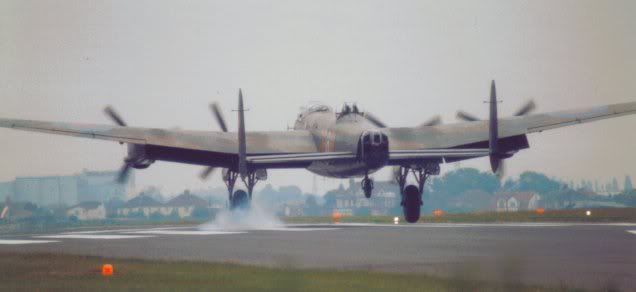

Did she not do something similar at Mildenhall a good few years back.
She also had a bit problem at Southend back in July 2002 when she cracked an undercarage leg.
http://img.photobucket.com/albums/v142/Southendnick/Southend%20Airport/lanclnd2.jpg
http://img.photobucket.com/albums/v142/Southendnick/Southend%20Airport/lanclnd.jpg
Not the landing above but her arrival after a display at Clacton
