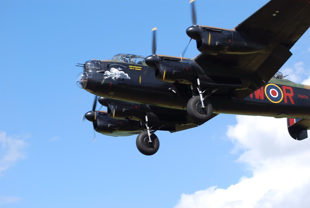

We had her stripped back to bare metal and split in half at Coventry – certainly better than the majority of airliners I’ve seen. We removed some minor surface corrosion at the back of the bomb doors where there had been a steel exhaust plate fitted during its test days. Aside from that, almost everything has been NDT’d in the last few years. New undercarriage legs (overhauled), engine mounts and subframes stripped and NDT’d.
I would say that with the exception of a few minor fixtures and fittings, PA474 is positively immaculate. I would GUESS that the unservicability issues this year are no worse than what has befel Sally B or any other warbird over time. Mechanical items do go wrong and sometimes what seems to be the logical ‘fix’ at the time does not cure any underlying problems. Its had a bad year. Unlucky.
I challenge you to find a boeing 737-200 (half the Lancs age) in as good condition….

Well she looked and sounded fine 3 hours ago as she returned to Norwich from Lowestoft airshow, she has less wrinkles than me ! although she is possibly younger ??
Keith.
http://i261.photobucket.com/albums/ii58/keithnewsome/norwich/DSC_0182.jpg
