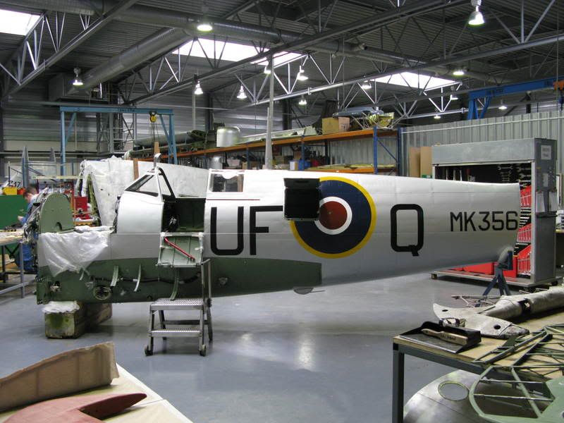

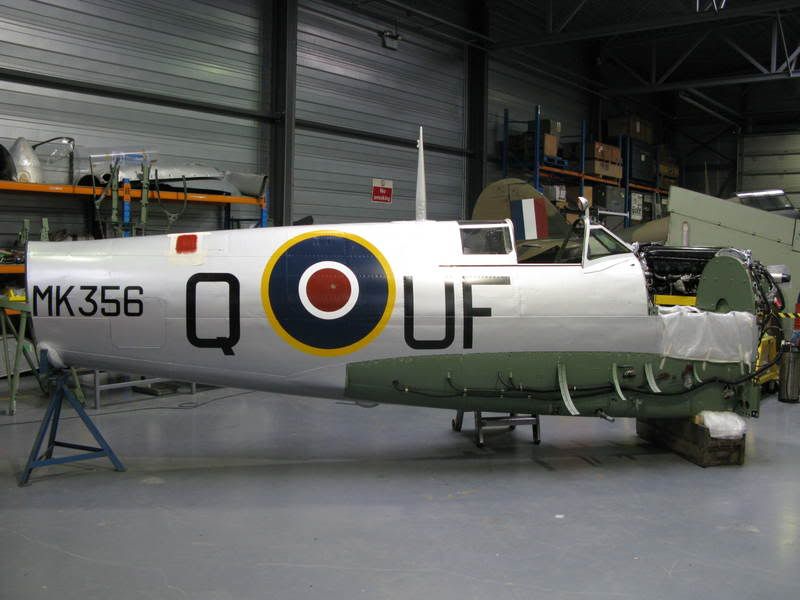

BBMF Spitfire MK356 Progress
Details of MK356 and the history of her new colours can be found at:
http://www.bbmf.co.uk/fighters.html
http://i130.photobucket.com/albums/p274/rum_monster/MK356/RHS_1_0420.jpg
http://i130.photobucket.com/albums/p274/rum_monster/MK356/LHS_1_0423.jpg

She is due out at the end of may after a re-spar, wing tip fit and engine replacement.
