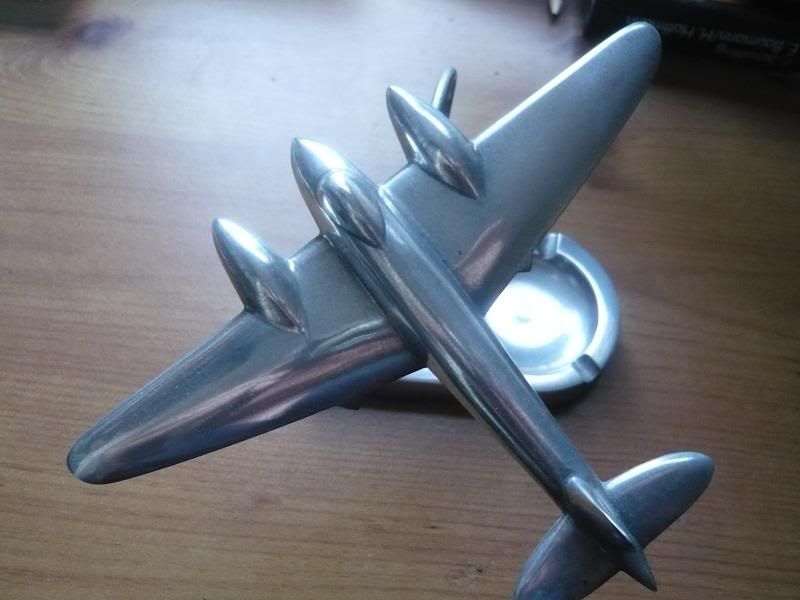

Even then, he found that the surface of the model had numerous imperfections from bubbles in the molten alloy. He devised a technique of shaving minute slivers of aluminium from scrap sheet, then hammering them (with a toffee hammer!) into the imperfections, with a final file/sand/polish to remove the excess. You had to see it to believe it, but once the whole thing was polished up, you could not tell what was original surface or “filled” surface (and years later, not one bit of aluminium has ever become dislodged).
He then turned to the detailing, by adding wheels, propellors (made from beaten and shaped knitting needles!) aerials and guns etc. Finally, he scribed the surface to reproduce panel lines, and roundels.
I have about two dozen of them: Spitfire, Hurricane, Defiant, Hotspur, Anson, Boston, Mosquito, Blenheim, Manchester, Lancaster and York.
I took the York to an aerojumble years ago, not really intending to sell it. An old chap stared at it for ages. He swore he’d last seen it on display in a cabinet at RAF Transport Command H.Q. – I didn’t put him right.
Sadly, I’ll have to part with them one day as I’ve no-one to leave them to but I think I’ll have them engraved with his name before I do.
Here’s the Manchester. The picture was for another purpose and doesn’t really do it justice.
