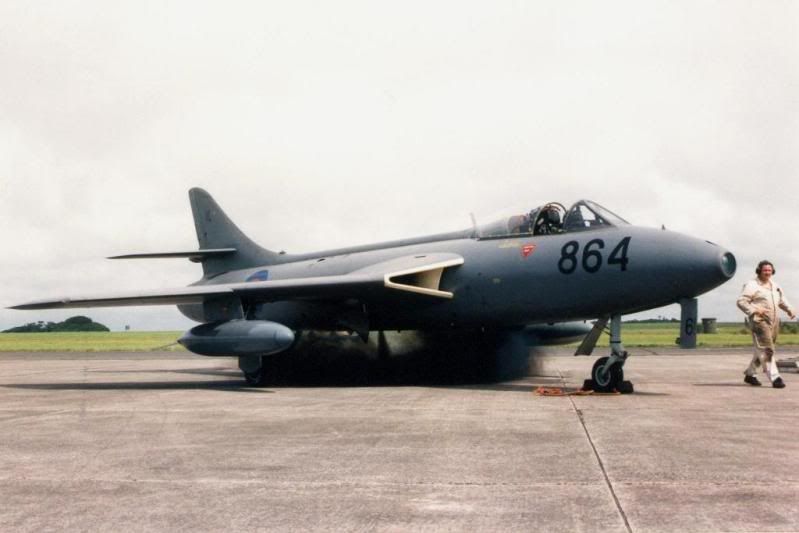

By: superplum - 4th September 2012 at 22:09
The deliberate and controlled force of black powder has other aviation uses,
http://i9.photobucket.com/albums/a82/pagen/st%20mawgan%20aircraft/sHUNTER2.jpg
But not in engine starter carts – usually a solid piece of cordite (or similar) to provide a progressive and controlled burn pattern.

By: pagen01 - 31st August 2012 at 22:03
