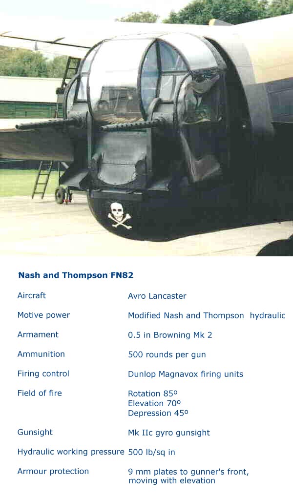

Yes this turret has been repaired with straight panels added,probably due to damage on the front perspex curves,my cupola is damaged in the same areas and making a pair (handed) of replacements with compound curves is a daunting task as the perpex panels are quite large.

this is an fn82 with fairings over the draught excluders under the guns.

It’s those ugly flat panels on NX611’s cupola that makes it look different.
My money is on a repair, due to the original double curved panels having been damaged at some stage. It may even be vandal damage since its arrival in the UK, perhaps when on display at Blackpool?

Fraser Nash FN82 Turret on Lancaster NX611 in UK:
http://www.tmquinn.net/airgunners/memorialroom/fn82.jpg

It seems the WA turret looks like a Boulton Paul Type D on top (upper cupola), BUT EXACTLY like the FN82 on the bottom (actual turret structure). I suggest it may be a modified FN82. Any other ideas?
