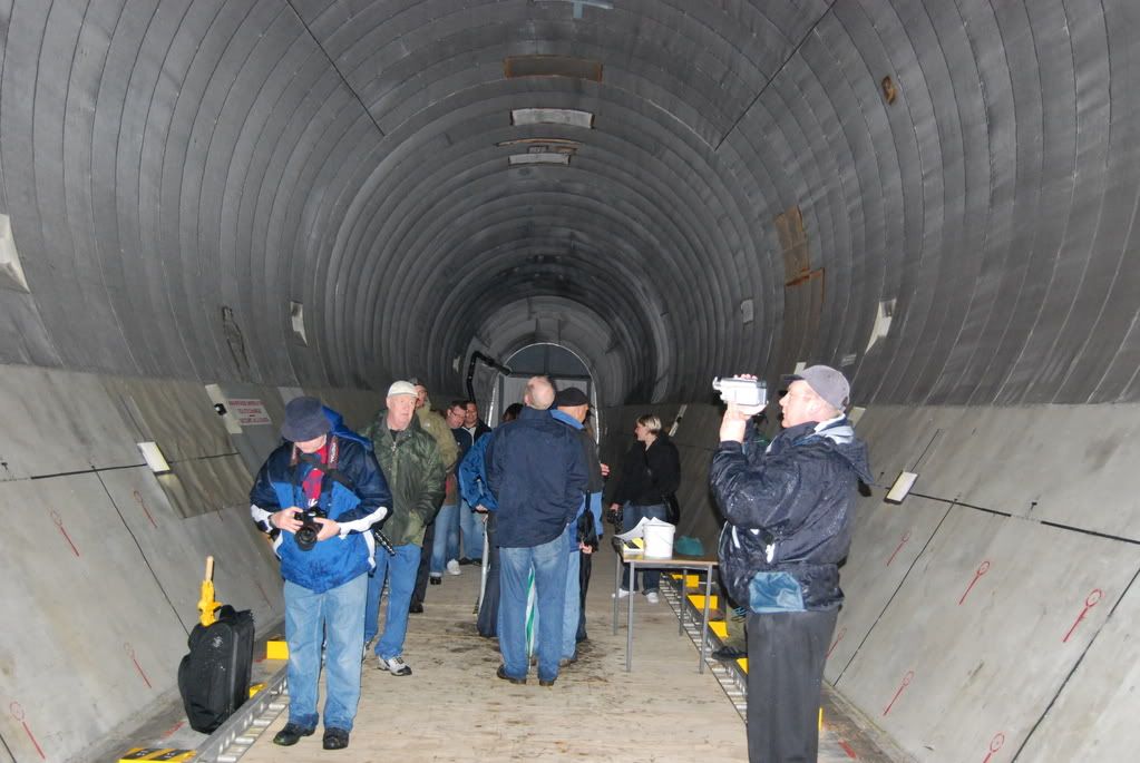

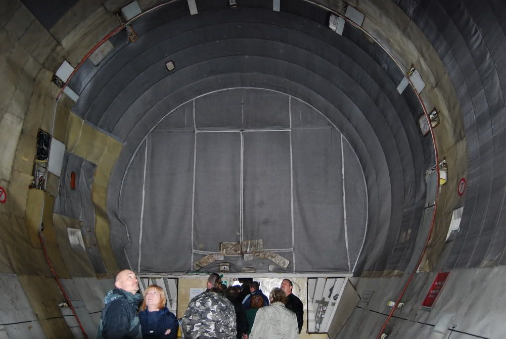

Speaking of the weather at Brunty on 25 May 08 (wet wet wet) a lot of people were very thankfull for being allowed inside the Guppy, myself included !
For those who have never, this is what it looks like
Looking aft.
http://i261.photobucket.com/albums/ii58/keithnewsome/bruntingthorpe/brunt002.jpg
Looking forward.
http://i261.photobucket.com/albums/ii58/keithnewsome/bruntingthorpe/brunt001.jpg
And out of the window / hatch.
http://i261.photobucket.com/albums/ii58/keithnewsome/bruntingthorpe/brunt003.jpg
