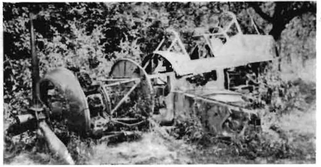

A long shot, but I once read in an old Air Pictorial that there was for a long time a Miles Master hulk on the edge of the airfield.
Martinet T Mk. 1 JN668/G-AKOS. Left to rot in a nearby orchard.
