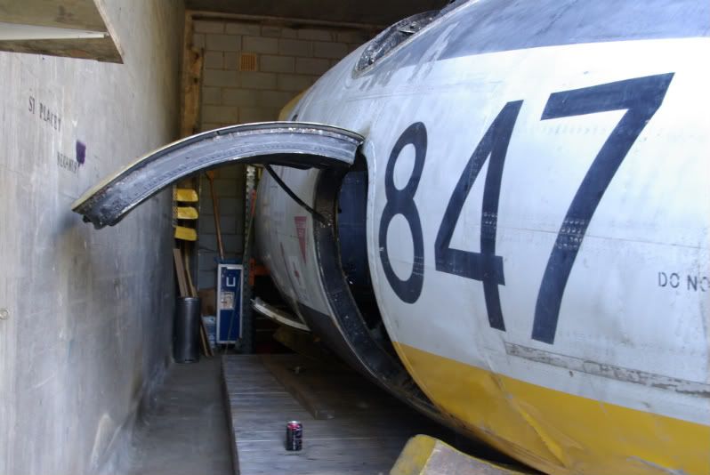

A very interesting Canberra you have there………do you know any of its history or its serial number?
Here is a pic of how the door should be supported with its prop:
http://i286.photobucket.com/albums/ll98/lightningnut_1980/SG102203.jpg
All the best Matt;)

By: bazv - 10th December 2008 at 12:45
The door support stay is curved and folds against the door for stowage(held by leather strap and press stud ?)there should be a fitting on the door to take the hinge pin.
The lower end of the stay slotted into a receptacle in the aft door frame.
I am sure one of the cockpit owners will post a photo for you
