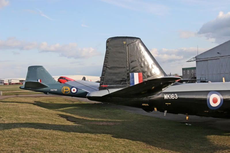

Here’s a long shot aimed at any Canberra experts:-
I’m dabbling with the new Airfix 48th scale Canberra kit and (as you might know) it suffers from some pretty difficult inaccuracies. The tailplane is just one problem, and the shape of the area where the tailplane fairs into the fuselage is wrong.
Putting it right requires some scrutiny of the upper surfaces so I wonder if anyone has any snapshots of the upper surface where the tailplane meets the fuselage?

Thanks for the feedback guys – much appreciated. I think the folks who designed the Airfix kit must have had some eyesight problems. Although the kit looks like a Canberra from a distance, the closer you look, the worse it is. The tailplane-to-fuselage joint is totally mis-placed (it touches the base of the fin at one point), and these photos help to establish its proper location.
Sadly, they’ve screwed-up on the wing tip shape too, the forward portion of the engine fairings, the lower nose, the nose glazed section, the base of the fin, the tip tanks, and the canopy. They’re just the main faults! Oh well, nothing like a challenge… 😀

Hopefully helpful Chox.

Here’s a shot I took of the tails of the two aircraft at Baginton. Hope it helps.
Tim
AACF Volunteer
http://img.photobucket.com/albums/v243/Consul/Cantails.jpg

Thanks for those, they are a big help!

By: scorpion63 - 26th April 2009 at 19:29
These any good
