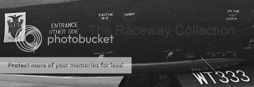

Ex 51sq Canberra WJ775 and have noticed alot of German writing underneth the English warning lables this would usally mean that the aircraft would have served in Germany but looking at WJ775 movement cards she was based in England with 192 & 51 squadron at Watton and Wyton.
All the best Matt;)
Most RAF combat types that operated in the European area had German language rescue markings, some had Norwegian and the PR9 fleet when, in Malta, had Maltese rescue markings although some also had Greek markings temporarily, so it’s not unusual to have a mixture of stencils nothing was standard particularly in the Canberra fleet!

By: alertken - 8th July 2009 at 23:05
No RAFG B.6s (B(I).6s to 5/12/69, B(I).8s to 6/6/72). WJ775 post-51 Sqdn sat from 9/74 for years on grass Swanton Morley as GIA 8581M with the Central Servicing Development Establishment, whose job included updating Engineering schedules for all RAFG types. There was never a Servicing need for German stencils in RAFG, only a Rescue one. I surmise…idle CSDE graffiti.

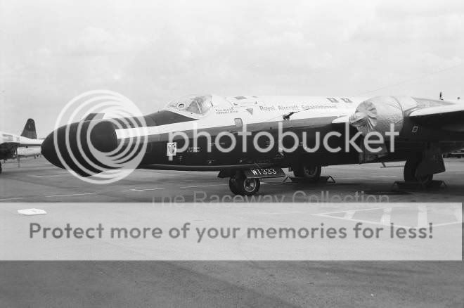

By: YellowAster - 8th July 2009 at 18:12
I’d guess the explanation is that 192 Sqn/51 Sqn Canberras regularly operated out of German airfields. I’ve seen photos of other 51 Sqn Canberras with external German warning legends.
By: Die_Noctuque - 8th July 2009 at 18:02
My thinking is that if WJ775 was built in a batch of standard B6’s which were destined for RAFG, then she may well have been finished at the factory with German stencilling accordingly. Of course we now think she may never have flown from Germany due to the cloak and dagger 51 Sqn work so it could be that a subsequent repaint saw the German markings being covered over..
Just a guess and based on nothing but my work-weary imagination!
