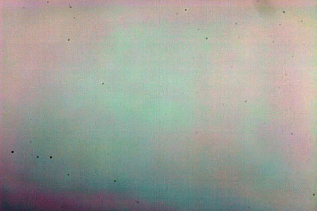

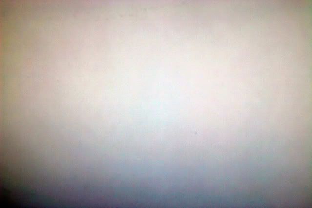

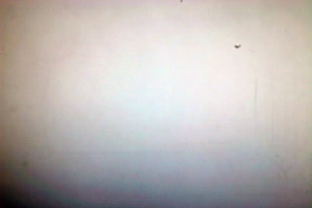

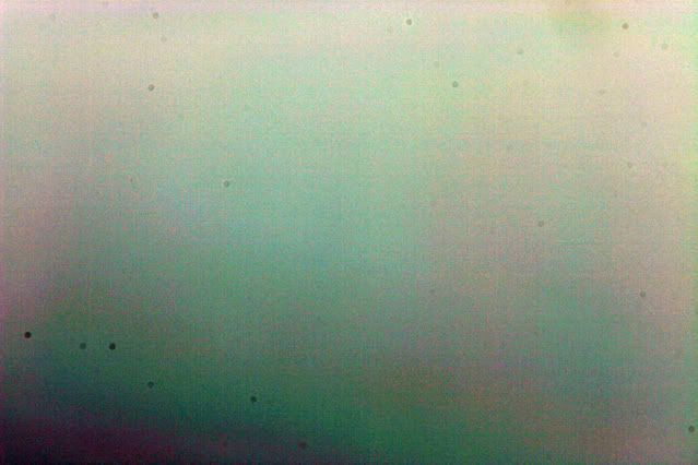

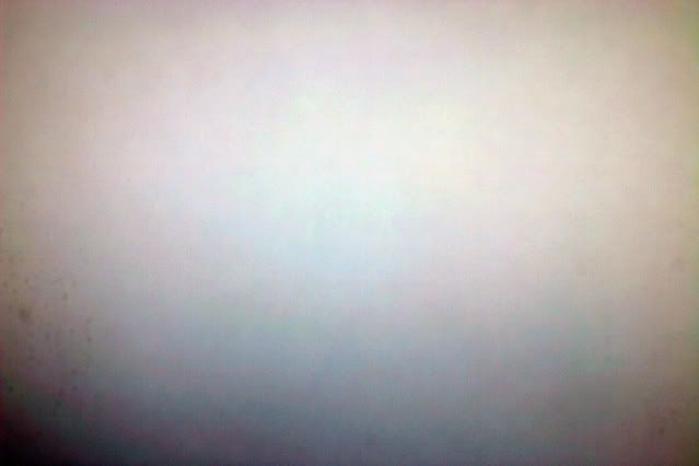

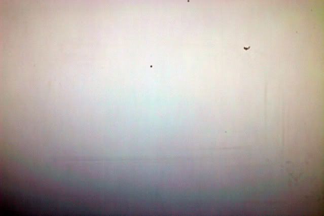

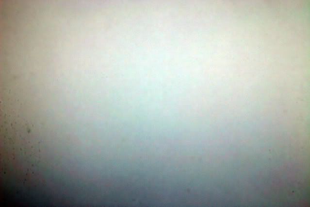

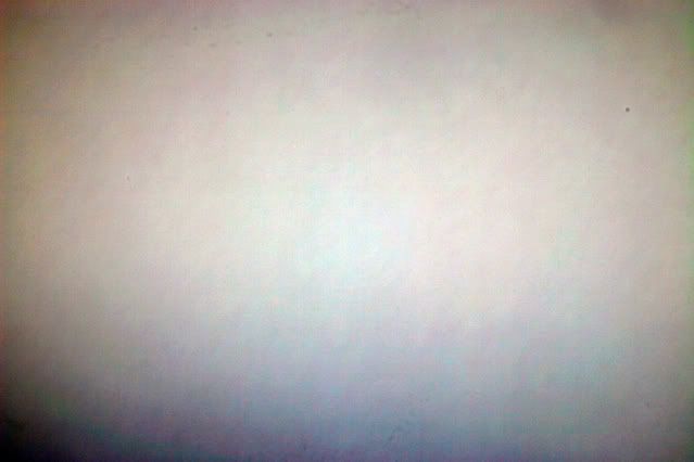

Here ya go, with pictures.
Taken at f/22 and f/16, MF-infinity and auto leveled- Cntrl+Shift+L on PS CS2. This shows you the scope of the NON problem.
http://img.photobucket.com/albums/v200/gjman/Sensor_Cleaning/th_20D_f22.jpg
http://img.photobucket.com/albums/v200/gjman/Sensor_Cleaning/th_20D_f16.jpg
Tools: CopperHill Imaging 14mm SensorSwipe (for APS-C sensors), Eclipse Cleaning Solution (Original not E2, E2 is for the cameras with self-cleaning ding dong), PecPads, scotch tape, giotto blower, some good old bollywood music and a relatively clean desk.
Put camera is sensor cleaning mode and squirted a few puffs of air using Giotto to dislodge any easily removable dust bunnies. And then did one sweep using the wet cleaning method
Can you see? Looks good, but not good enough. Can you see?
http://img.photobucket.com/albums/v200/gjman/Sensor_Cleaning/th_20D_f22_firstpass.jpg
http://img.photobucket.com/albums/v200/gjman/Sensor_Cleaning/th_20D_f16_firstpass.jpg
Second Pass and this time I cheated, I know from experince that most of the crud is swept to the edges of the frame, so I did the usual wet cleaning and I also cleaned the edges (in a rectangular, anti-clockwise manner) with a PecPad wrapped on a QTip. Can you see? I just messed it up even more? Look at the crud? Those streaks, that crud? OMG!!!
http://img.photobucket.com/albums/v200/gjman/Sensor_Cleaning/th_20D_f22_secondpass.jpg
http://img.photobucket.com/albums/v200/gjman/Sensor_Cleaning/th_20D_f16_secondpass.jpg
So I wrapped another PecPad on the sensor sweep and repeated the first pass. And this is what I got. I can live with this at f/16 (coz I don’t plan to shoot below f/8 over the coming weeks)
http://img.photobucket.com/albums/v200/gjman/Sensor_Cleaning/th_20D_f22_thirdpass.jpg
http://img.photobucket.com/albums/v200/gjman/Sensor_Cleaning/th_20D_f16_thirdpass.jpg
Its really that easy. Even a mathematician, statistician or even an Oracle can do it.

By: GliderSpit - 6th October 2007 at 16:47
Post up a pic @ f/22, MF infinity. If you have CS2 then auto level it.
Also I suggest seeing what the same spot looks like @ f/16. I don’t go smaller than f/16 in actual application, f/22 is used to benchmark the cleaning. If the spot does not show up at f/16 then you are good to go.
If the spot is at the edge of the frame then you might have to wrap some Pec Pads on a Q-tip (or buy a $40 edge wand) see if that helps.
Remember it will take you about 2-3 tries before it becomes routine.
Thanks for encouraging me. I have tried 3 times to clean up to now. I made a couple of test pics this afternoon at different apertures. At f11 you can just see the dot that is difficult of remove. It is about halfway from the centre to the top of the picture. In the shop where I bought the stuff I was told to sweep one time forward and one time backwards with the 1.6* swab. Do people sweep more often and in different directions?
I feel comfortable while sweeping the sensor. The only thing that irritates me, is that I am not 100% succesful.:mad:
