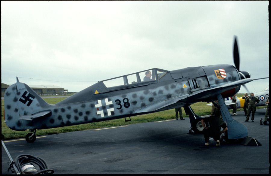

FW 190
I do have somewhere photo’s of the Fiat CR42,BF110,ME410 and Stuka ground running I think one or two of the others also ran.
It is the dim and distant past but from memory it was in the earl/mid 1970’s.
This was ground run at ST Athan in the 80’s, one aircraft that springs to mind is black 6, it should never have been put in a museum it the first place.
