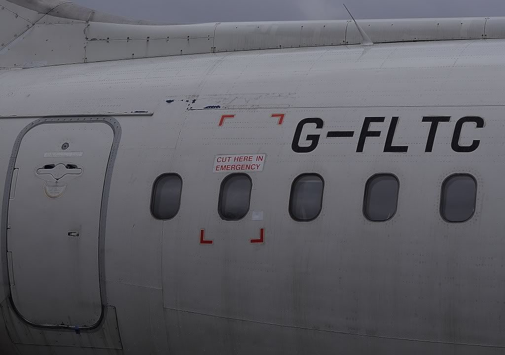

Technical question here ? I am sure we have all seen this label attached to specific areas on most aircraft ??
My question is …. what makes the outlined area the prefered area to cut in an emergency ??
Is it a weaker area especialy built in to allow easier cutting …. cutting with what ??? …. firefighters axe …. ??
Is it selected because there are less obstructions within the skin of the airframe, stringers, frames, pipework, cables etc ….. ?
Is it selected because there are less obstructions within the cabin, seats, toilets, cabin fixtures in that area …. ??
I know nothing !! Over to those who do ??
Keith.

It occurs to me that I don’t know of any accident where cutting along the dotted line was both necessary and possible.
Has anyone ever seen it done?
We have tried this with the standard issue fire axe ,,,nigh on impossible ,,even if you get through the outer skin you have hatbins and interior trim to contend with,,even with a petrol cutter in the mayhem of possible leaking fuel and fluids this will be a risky process ,as most of you know i pull apart various airframes with a more than adequate machine and even this struggles sometimes,,

but…..whats wrong with the door beside the cut area? seems a little pointless to put a door next to a cut area, thats just a waste of hinges!
Doors/hatches can be jammed due to Airframe damage/distortion !So just a belt and braces approach to that eventuallity !

I was just going to ask something similar: do the manufacturers have to dedicate an area of the aircraft to have these sections i.e. ensure certain areas are relatively ‘free’ for this purpose? Or are they considered near the end, and decide where to assign the cut-out section later?
By: MD-80 - 14th October 2010 at 01:17
I think that such marked areas are mandatory in some countries while in other countries not?

The short answer is ‘yes’
Usually, the area will be free of heavy structure, hydraulic pipelines, air conditioning ducts, etc. A fire axe will go through the skin and stringers with reletively little effort. In my experience, you have to be pretty dedicated to the task to cut a human-sized hole in any aluminium aircraft.
The standard aircraft fire axe (rounded blade, 8″ point on the other end) is a superb multi-use tool. I have cut down trees with mine!
