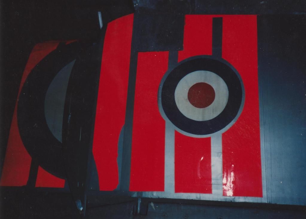

My fabric has been removed off my wings, but this is interesting. Looks like it is peeling off the silver like tape might?
That is dayglo film, on large areas it is laid in parallel strips (8″ wide strips with 2″ gaps for example), it can go hardish and flake away as appears in your pic.
When dayglo is painted on the whole area is done in solid colour.

Here is a pic taken of Hanks AOP-6 Auster during rebuild. He used the wings of another HK T7 (WE537 I think). My fabric has been removed off my wings, but this is interesting. Looks like it is peeling off the silver like tape might?
