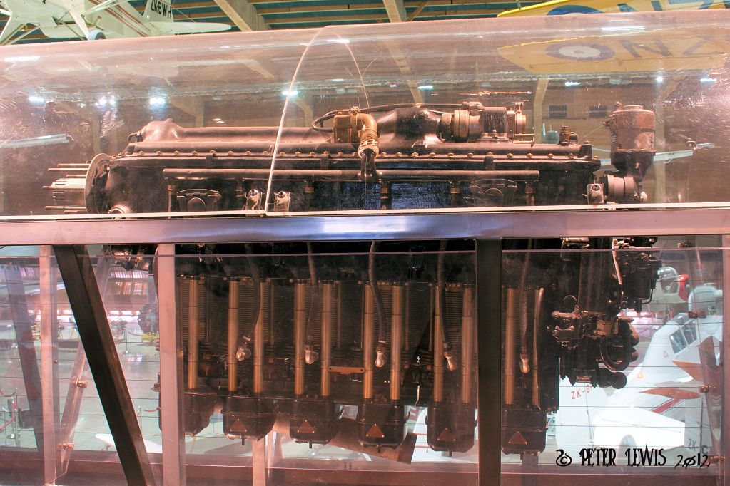

Is that a safe presumption to make? If it is decided to hang the Gull in an airport terminal in a position in which, I understand, it’s not easily viewed, why not extract the engine first? Presumably no-one can see that it’s not there, the airline passengers probably don’t care and it makes suspension easier and less expensive! But if the engine on display at MoTaT has been extracted from Jean Batten’s Gull, then it’s a funny old world in which the engine warrants exhibition in a national museum whereas the airframe itself serves, at best, as little more than a minor diversion for delayed airline passengers!

I presume that this is a spare Six that went with the a/c, rather than them actually removing it from the Gull before it was hung-up….?

Out of interest, the ex-G-ADPR Gipsy Six on display in its perspex case at MoTAT. Photograph taken today.
(No sign of the reputed Pobjoy though! Maybe that one is stored).

Jean Batten’s Gull G-ADPR / ZK-DPR is on display at Auckland International, and the Six from it is in a glass case in the new hangar at MoTAT.
