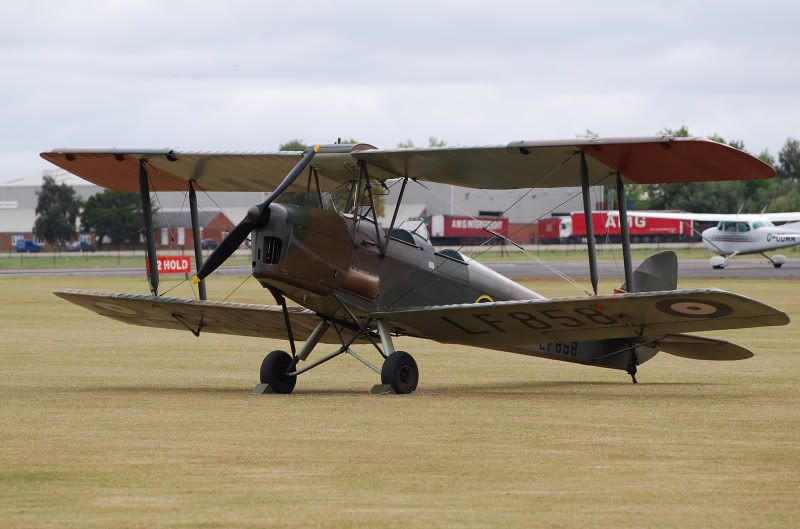

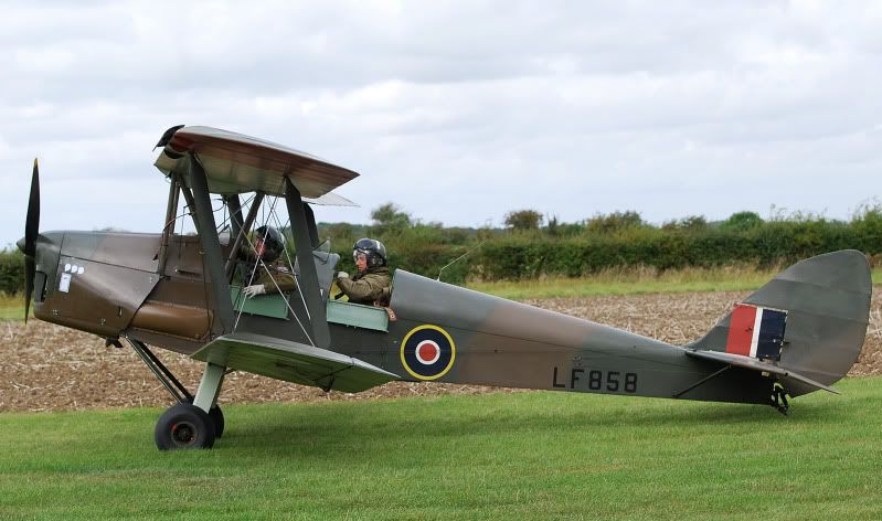

By: keithnewsome - 29th October 2009 at 22:45
Couple of photos of the flying example, both from 2009, Little Gransden and North Weald …. Keith.
http://i261.photobucket.com/albums/ii58/keithnewsome/lt%20gransden/DSC_0015.jpg
http://i261.photobucket.com/albums/ii58/keithnewsome/spirit%20of%20nw/DSC_0246.jpg
