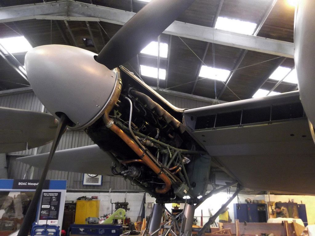

By: Bruce - 20th December 2015 at 13:46
Rear pair are siamesed together, owing to close proximity to the wing/radiator.

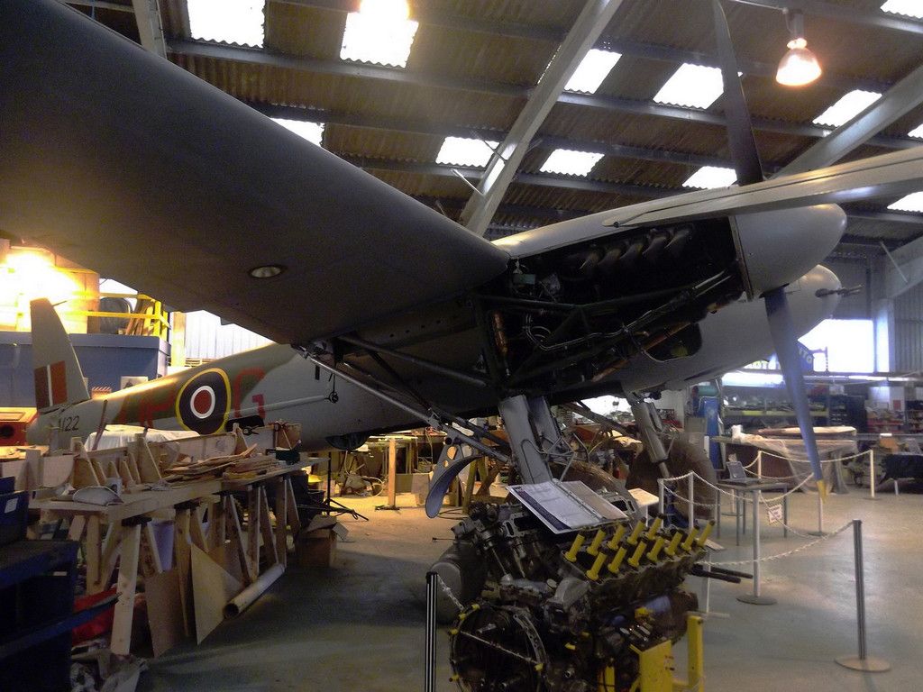

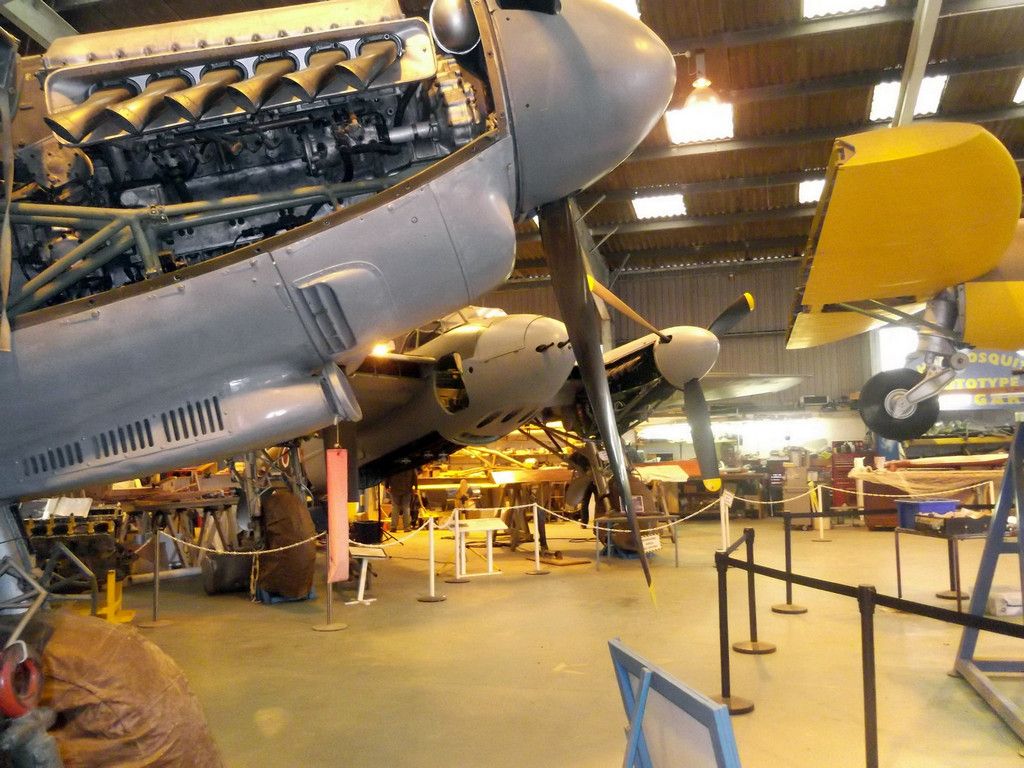

Despite being in close proximity to Mosquito engines not so long ago, I hadn’t noticed that – even when photographing them! Looking back on the photos, I see what you mean.
For comparison, in the foreground of the top photo is the B.35 and the others are the FB.VI (both DH Museum). Not that it answers your question!
