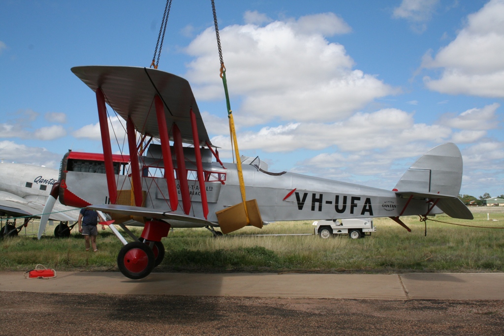

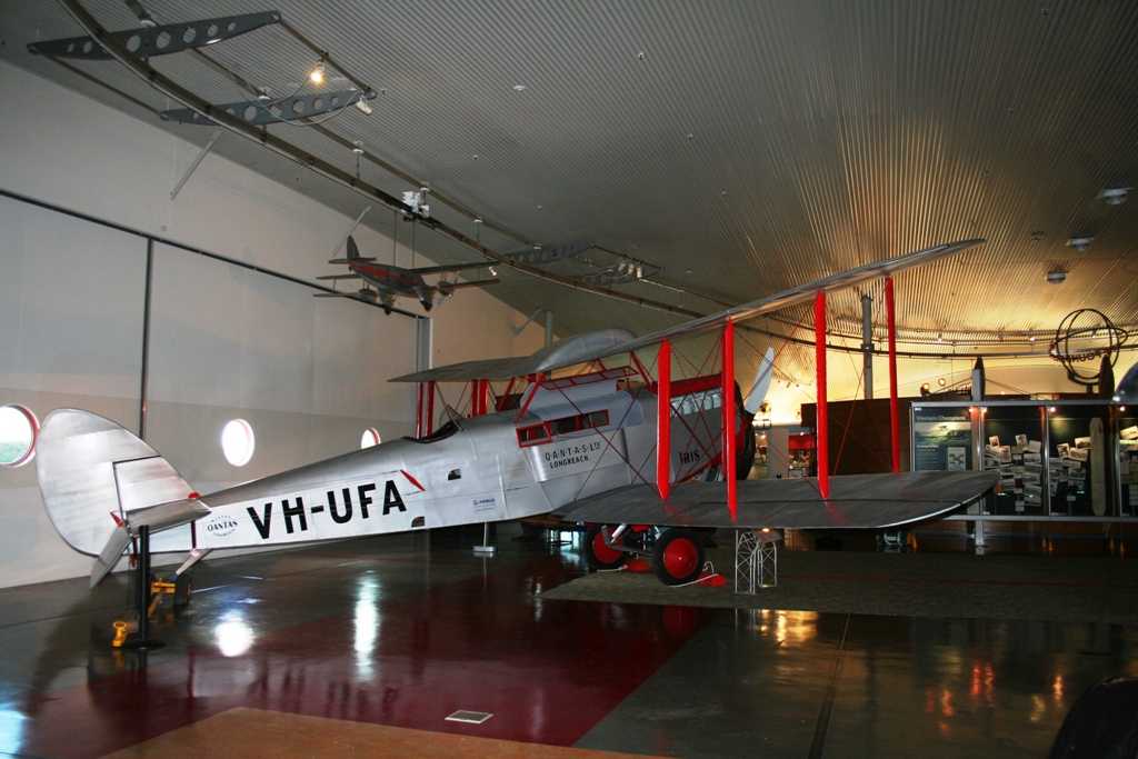

a few weeks ago we finished this DH50 non flying replica for QANTAS Founders Outback Museum in Longreach, Queensland.
It lacks exhaust system, wingtip skids and some other features which will be added early in 2011.
It joins the DH61 replica there as a reminder of QANTAS’s early history.
Still to come in the years ahead are the Be2e, Armstrong Whitworth FK8, DH86 and Shorts S23 Empire.

We make moulds for the wings (from a fabric covered wing),tail surfaces, engine and struts, and building jigs for the propellers. The rest is steel tube closely following the equivalent size and positioned spruce of the original, covered with flat fibreglass panelling.
Our flying wires are precision cut (Abrasive Water Jet) flat bar with rounded edges.
We hope the replicas will last indefinitely with practically no maintenance, and they are robust enough to be interactive, so within reason patrons can touch and have access to them inside and out.
DH86 and S23 will be full sized. That means they can never be fully assembled in my workshop. The S23 poses some challenges, and will need engineering input, but should be quite striking. It will float in a purpose-built harbour.
