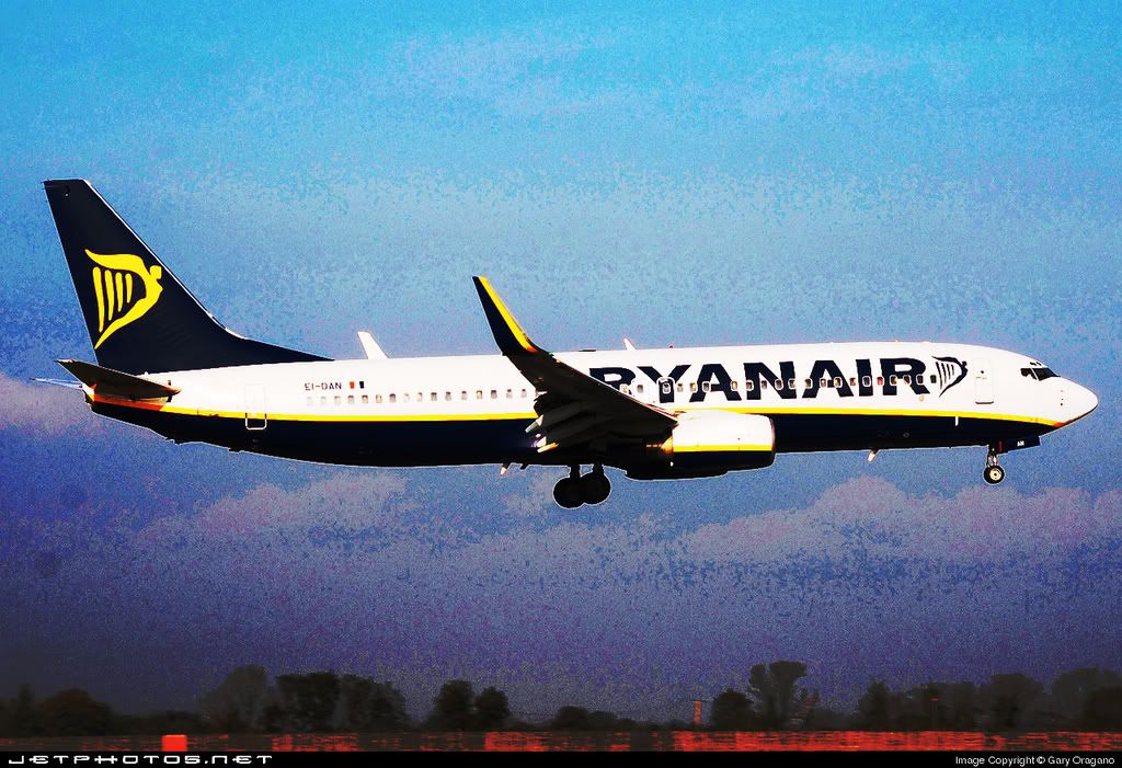

Hello,
Could someone tell me where the dust spots are on this photo
http://www.jetphotos.net//viewreject_b.php?id=1655851
I cant see them,i did my best to clean it up in photoshop,but i didnt realise i had dust on my CCD,and i’ve ruined about 2 months worth of decent photos,i cleaned the camera yesterday but it’s too late to save the photos even with photoshop judging by this photo.

[IMG]
It does pay to keep your sensor clean, and I usually sensor swab my 30D once every 3 or so months. I’m sure some of your images can be rescued. If you’d like me to have a go at getting rid of the spots on a few of them just drop me a PM and I’d be more than happy to.

Hi Gary,
Hopefully this will help:
http://i2.photobucket.com/albums/y36/MMSR5/More%20Stuff/96101_1193929828-Equalise.jpg
Paul
1,463
By: adamdowley - 3rd November 2007 at 17:42
There are no ‘dust spots’ as such but I think the screener is refering to the ‘dirty’ halo around the aircraft – it looks a compression issue more than anything else – the sort of thing you see when a file has been saved with a high compression rate.
