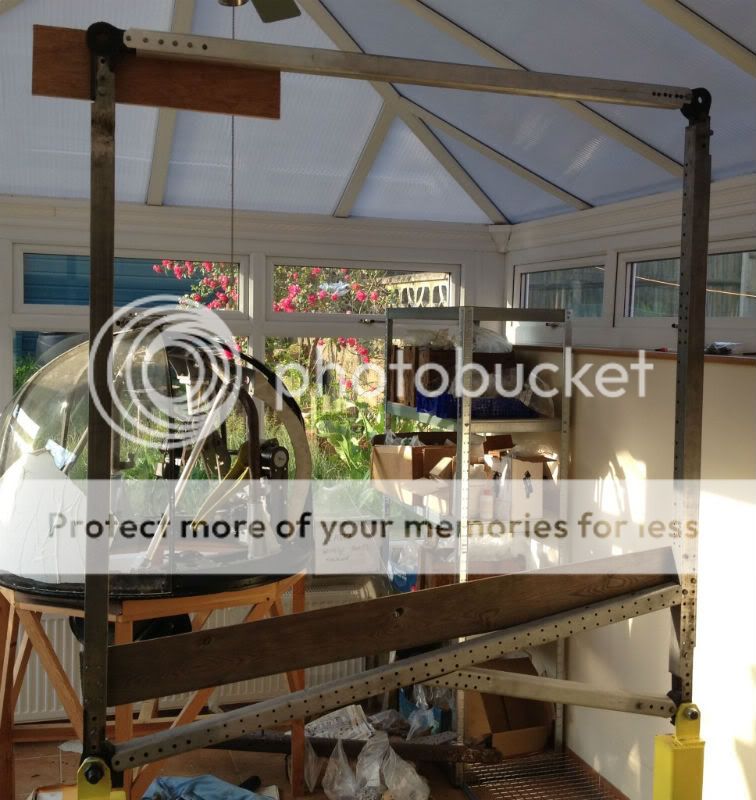

June 17, 2012 at 4:57 pm
Can anyone help with leads as to where I can purchase some please?
Thanks
Elliott

By: GrahamF - 18th June 2012 at 08:14
Thanks
Elliott
I’ve got an accurate frame 11 profile in CAD if that’s any good?
Drawn up using the Supermarine Layout chart.
Graham
