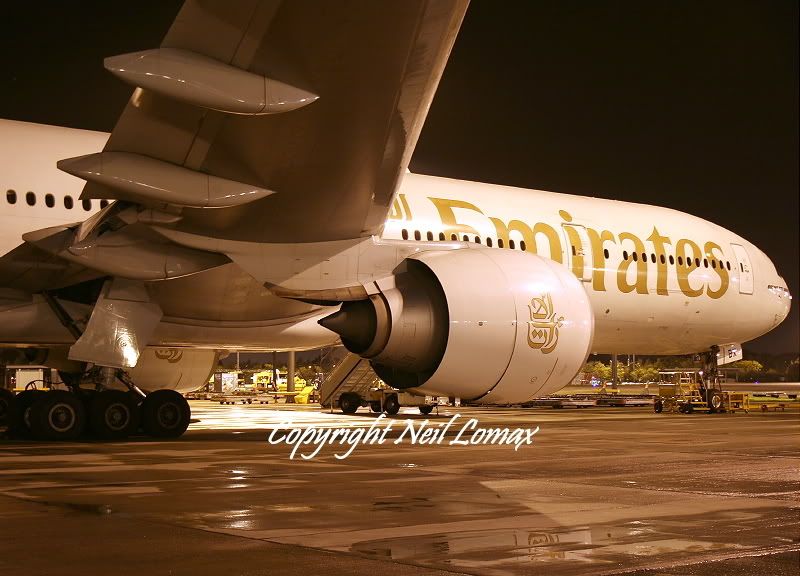

Emirates fixed it themselves in TC’s shed. The engine was not changed in one “Lump” the propulsor or core part of the engine was. The Fan was not damaged so it did not need changing. It is a standard proceedure for the GE90 to do that when it is down the line because the whole engine is so large it is very difficult to ship one.
I THINK that you can only just get a “Bare” engine into an AN-124.
The propulsor came in on a TNT 747. It was well photographed when it was on the ramp.

Sam, I think the flight aborted his takeoff earlier in the day due to an engine problem. He asked the Fire Services to also check the brakes – I’ve heard it needs the engine replacing, I don’t know if that is true or not. There was 3 Emirates 777s in today –

Heard it was a bird strike. Replacement engine is due Sunday, apparently brought on an EK 74F.

The engine is being replaced, it failed during take off.

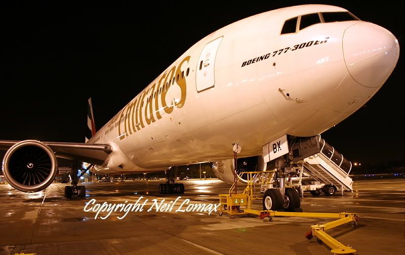

By: TRIDENT MAN - 24th October 2008 at 12:44
Sam,seems to be a problem with the stbd engine,cowlings left unlatched this morning,here are a couple of piccy’s………………
http://i136.photobucket.com/albums/q193/Neil2312/IMG_5044.jpg
http://i136.photobucket.com/albums/q193/Neil2312/IMG_5053.jpg
