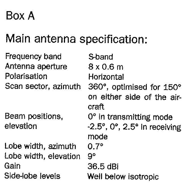

Erieye Antenna Characteristics
Scanning Area of Erieye
Antenna Aperture
Antenna System
Cross-Section of Dorsal Unit

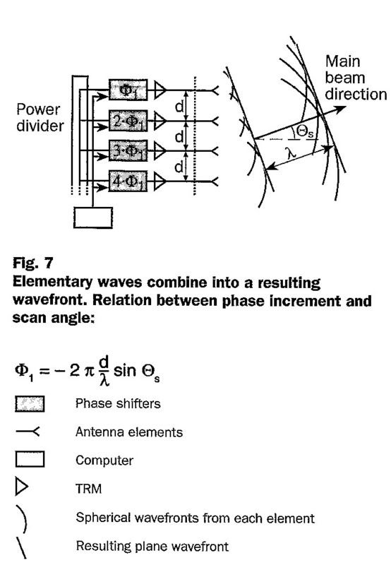

Phase Increment & Scan Angle Relation
Compare the above mentioned antenna specs[from 1995] with following from 1990.
Source:
Military microwaves ’90 : conference proceedings, Wednesday 11th to Friday 13th July 1990, Wembley Conference Centre, London
Article Author: Affiliated with Ericsson.
Article Title: A phased array radar antenna for airborne early warning
Old Antenna Min. Perf. Specs
even here it is claimed that it 120 degrees on each side was the minimum they wanted to attain. They eventually were able to optimize it for 150 degrees on each side by 1995.
And since it is clearly a simple planar phased array, the performance after 120 degrees would be severely limited. So, there will be drastic degradation at the extremes 15 degrees of the coverage.
