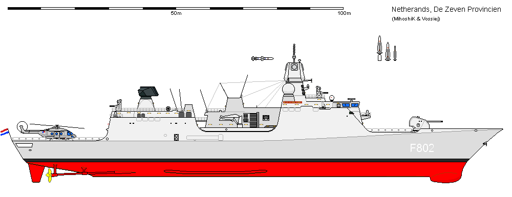

I present you my pet project that I started working on when I began drawing ships inspired by MihoshiKs great works some two years ago. Most of those drawings have been online on shipbucket for some time. I just recently modified them and wanted to show you first.
What if European Nato countries (and Canada) would have agreed on one common set of AAW system instead of going PAAMS, AEGIS and APAR? My approach was that like The Netherlands, Germany and initially Spain in the Tri-national agreement, every country would build its own platform and choose most systems to their national needs and standardization. Only the AAW set would be the same in all ships. To save some development costs all choose the USN AEGIS system as basis to start from. The system would be modified (in Europe of course;-)) to allow an open architecture to work with the many different systems each nation would cling to (like SSMs, CIWS/ILMS, Torpedos, Elo/Optical systems etc), in essence only the core AAW component would remain the same. That would be adapted to work with the European developed APAR/Smart-L/Sirius combination rather than the “older” Spy-1D/SPG-62/SPQ-9B combination. Added to that there would be an additional production line for ESSM (which is a multi-national NATO program anyway) and SM-2 (in license) in Europe.
To save development cost on the platforms as well (and to satisfy my love for ship families;-)) most partner nations would base there AAW ships on platforms that entered service right before. Those would of course be modified to fit the needs of more “stealth” and the additional space and weight needed for the high masts (much like the German F124 Sachsen class which is based on a 5m lengthened and 0.7m widened F123 Brandenburg class).
So here they are all at once (except for the Greek FREMM based version, sorry for that:-)
http://i90.photobucket.com/albums/k279/shipbucket/Ship%20Charts/APAR.gif
Hope you like them. Thoughts and comments are always welcomed and eagerly awaited.
Regards.

No, no, no! EH-101 & NH90 are different enough to keep for different roles. EH101 is quite a lot bigger.
I knew that this would stir up some emotions:-))) It is bigger, it has a longer range and it is more expansive. Fact remains do we need both especially do countries like the UK and Italy need both (or in case of the UK Lynx and EH-101) or wouldnΒ΄t reduction in models make a lot of sense for them too? I think the later. Besides NH-90 with Merlins ASW set would be great as well, donΒ΄t you think? Anyway …. (see below)
Since any sensible all-European naval co-operation deal would involve completing the CVFs & PA02 to the same CTOL standard, why go to the trouble & expense of developing a Sea Typhoon? Rafale as the carrier fighter, Typhoon as the land-based fighter. Commonality of systems where appropriate. Otherwise, we’re re-visiting procurement decisions from 20 years ago, which I think is going back a bit too far.
Ok I can agree on all that especially considering the last sentence which is also true for the choppers above. For the sake of argument though (sorry cannot resist ;-)) one fighter in two configurations would have been better than two different models.
Thanks for the good discussion,
Regards.

One thing worth noting is that the Meteor missile is of a smaller diameter than the ESSM, so it may be possible to quad-pack them. I am not sure if this would work with the Sylver launchers, but it should work with the Mk41. It may well work with the Sylver though, which could make it an attractive option for France, the UK, and potentially a variety of other countries.
By: MConrads - 4th June 2007 at 20:16
Hi,
Cheat! π
Yeah, I tend to do that. One other thing that would need to be different from the onset is APARs capability for Aster missile uplink capability. If I remember my radar guru 7seas correctly, APAR could be used for that task but would need one of its pencil beams for each missile uplink therefor decreasing its surveillance capability. So that would need to be different as well. Though both issues could be feasibly solved.
Of course, if the NSM is partly American (I’m not sure) it might be possible to substitute non-US competitions.
Now that would be possible. If the NSM program would be targeted at a much larger market (all European Navies for the next 20 years!) it might be possible without US corporate involvement. Its settled than (Why cheat only ones?!)
Agreed about Mistral. Not in the same league as IRIS-T or RAM. Mica-VL & VL Seawolf are nearest, but a bit bigger, heavier, & probably more expensive.
Seawolf is out of the question. While being a good SAM it needs separate illuminators and IΒ΄d like to prevent that. VL Mica would work however it would again increase France work share over the other nations share. ThatΒ΄s why I opted for Iris-T SL in the first place.

Hi again,
You are right. I would just assume that the two different boosters were envisioned from the onset of the project:-))
Cheat! π
I hadnΒ΄t considered that for NSM because I didnΒ΄t know. That would indeed be disadvantageous for exports. Ok, than if we choose another all European missile that will end up larger anyway increasing the need for a smaller helicopter launched ASM even more. A Brimstone derivate is fine with me. What about the heavy SSM than. I really like the RBS-15 mk3 though it wouldnΒ΄t fit in my idea of spreading work share between partner nations since Sweden isnΒ΄t a partner. MM-40 block 3 Exocett is looking good too, though it would mean even more work share for the French industry. Leaves the outsider Otomat Teseo mk2 block IV (?). That would work since IΒ΄d really like to have a VL Milas for the ASW ships;-))
Regarding RAM, you are right of course. But what are the alternatives for a ILMS? Mistral, no thank you. I think RAM would be good as an interim solution until Iris-T SL is fully operational in the next decade. Besides there wont be many exports for these high-end ships anyway as shown in the real world. Those would have to make due with the PAAMS and the Sea Guard systems.
Thoughts?
Regards.
No big arguments. I expressed concern about US content not with thoughts of exporting the ships, but the missiles, for mounting on other platforms. If one type was generally adopted, it would marginalise the others, harming their sales prospects. Of course, it the NSM is partly American (I’m not sure) it might be possible to substitute non-US components.

Hi again,
great input, thanks a lot.
One quibble there: developing a new Aster 15 booster would take some time, so would put that outside your timescale as well.
Yes, NSM looks like a good candidate for a single replacement for all the heavy missiles. I disagreed with it as a replacement for Sea Skua because they’re in complementary classes, rather than competing. …
My only caveat is whether NSM has significant US components. It would be unwise to subject the only anti-ship missile to US restrictions. That’s also an overwhelming disadvantage of Hellfire as the light missile for helicopters & a UAV missile, & RAM as the sole short-range naval SAM. What about exports?
Thoughts?
Regards.

Hi,
thanks for responds.
Yea I know that it is much larger. It also has a much longer range. It is also the only large SSM that can be launched by the NH-90 helicopter. My goal was to replace as many different systems with as few as possible to make each new developed system affordable. You are right that the need would be there for an additional smaller missiles that could also be launched from UAVs. Brimstone is a good example, Hellfire or PARS 3 LR would be another. Still I thing that NSM would be a great European replacement for air and surface launched SSMs like Harpoon, Exocett, Otomat, Kormoran etc.
You are right. Aster 15 cannot be dual packed. I should have added that the Aster 15 booster I envisioned is the same LENGTH as the Aster 30 booster but much smaller in width. I tried to convey that in the drawing but I should have told you, sorry.
Well first of all RAM is a 50/50 joint venture between Germany and the USA. So it is more European than ESSM is right now. Iris-T SL is a great concept and would fir in nicely with my idea of generalizing land and sea based AAW assets. Sadly Iris-T SL would not have been ready for the generation of warships I presented here. I would suggest that Iris-T SL replaces RAM on the next generation of ships.
Scalp Naval would not be ready for those AAW ships as well. Besides I think there would be little space left for additional vls cells (look at the real world F100, LCF or F124). But in my opinion that is not really a drawback. Let those AAW ships be AAW ships. The next Generation should be oriented toward land attack and asymmetric warfare, just as my alternate F125:
Looking forward to your answer.
Regards.
That all makes sense. You’re right, I’d missed your idea of a new, slimmer booster for Aster 15, & didn’t appreciate your timescales. One quibble there: developing a new Aster 15 booster would take some time, so would put that outside your timescale as well.
Yes, NSM looks like a good candidate for a single replacement for all the heavy missiles. I disagreed with it as a replacement for Sea Skua because they’re in complementary classes, rather than competing. Sea Skua (like As.15TT) is carried by smaller helicopters, & in larger numbers, for use against smaller targets. Yes, PARS 3 LR is another candidate, but I’m concerned about its short range.
My only caveat is whether NSM has significant US components, as Penguin does. It would be unwise to subject the only anti-ship missile to US restrictions. That’s also an overwhelming disadvantage of Hellfire as the light missile for helicopters & a UAV missile, & RAM as the sole short-range naval SAM. What about exports? I’m not sure if Brimstone suffers from that problem (the head of the development team once said it shares one rivet with Hellfire π ), but it’s something that should be borne in mind. Remember that the USA has not been above refusing or delaying export licences so that a US product wins an export contract instead of a non-US product with US components, & these are markets where European producers currently have significant business.

Hi,
NSM isn’t really a suitable replacement for Sea Skua. NSM weighs 3 times as much as Sea Skua, which is a light, short-range weapon for blatting small vessels. Could be replaced by a development of Brimstone, perhaps.
I’m pretty sure you can’t dual-pack Aster 15 into Sylver A50. A50 is the same width as A43, which is the Aster 15 launcher, & AFAIK the Aster 15 booster is the same width as (but shorter than) the Aster 30 booster. You might be able to quad-pack a smaller missile, e.g. VL Mica or Iris-T.
BTW, the Iris-T SL might be a better candidate for a German short-range SAM than RAM, which is rather American.
What about Scalp Naval?
Nice drawings.
Regards.
By: swerve - 3rd June 2007 at 15:31

Thanks guys, glad you like them. In case some of you have wondered here is a little info on each ship:
The Royal Navy ship is based on a VT proposal of a Aster 15 armed stretched Duke class (dubbed Super Duke). The Norwegian design is based on the APAR equipped Meko A200 that Blohm & Voss offered in the Nansen contender against BazanΒ΄s F85 design. The Italian is a stealthyfied Luigi de la Penne class. The Canadian design is actually based on a proposed stretched and mk-41 vls equipped batch II Halifax class. Finally the Spanish ship is based on an official drawing that was made before Spain opted against the APAR an in favor of the Aegis system.
Any comments on the scenario as well?
