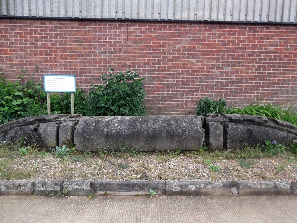

Photographed the fuselage mould at the DH museum less than 2 weeks back –
http://i95.photobucket.com/albums/l134/mmx16/DSCF0781_zpstyqfnfks.jpg
What you are looking at here is (from left to right) –
LH nose mould – from front angle bulkhead to the main spar.
LH centre section mould – from main spar, bulkhead 2 to bulkhead 3.
RH nose mould – from front angle bulkhead to the main spar.

. Dc103, did they do Hornet stuff? Given the sawdust in your blood, how hard will it be to get the concrete Hornet fuselage former at the DH Museum and make up a fuselage? :-))
I don’t know if Wrighton’s did other fuselages? The only production line photo’s I have seen showing Hornet fuselage woodwork under construction, appear to be in a large hangar, which could be at Hatfield between 1944-45.
I have seen Vampire wooden fuselage halves being constructed in smaller workshops though, so it would make sense for suppliers such as Wrightons continuing to make components for DH post-war. With Hatfield turning over much of its production space to types such as the Dove and Comet post-war, it would make sense for them keep the dirtier jobs in supplier companies, while retaining the final assembly in the main factories.
As for your idea about the concrete mould: I looked at using this about 15 years ago, and although it is a nice relic of the original production process, it is incomplete and not useable without extensive repair. This would only detract from its originality.
I’ve got all the necessary drawings to re-construct a Hornet from scratch, including the co-ordinates for the fuselage moulds. Throw enough money and time at it, and I could produce a wooden fuselage mould the same as Glyn Powell has done with the Mosquito in NZ.
The difference between the types though, is that enough parts and interest in the Mosquito exist to justify a potential investors input – there is not for the Hornet.
