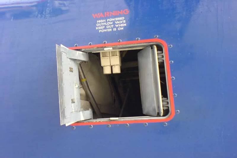

It’s the outflow valve,
http://i101.photobucket.com/albums/m63/Cking507/DSC00168.jpg
It contols the cabin presurization by modulating the rate at wich the pressurized cabin air is released from the aircraft. It is controlled by two pressurization controlers.

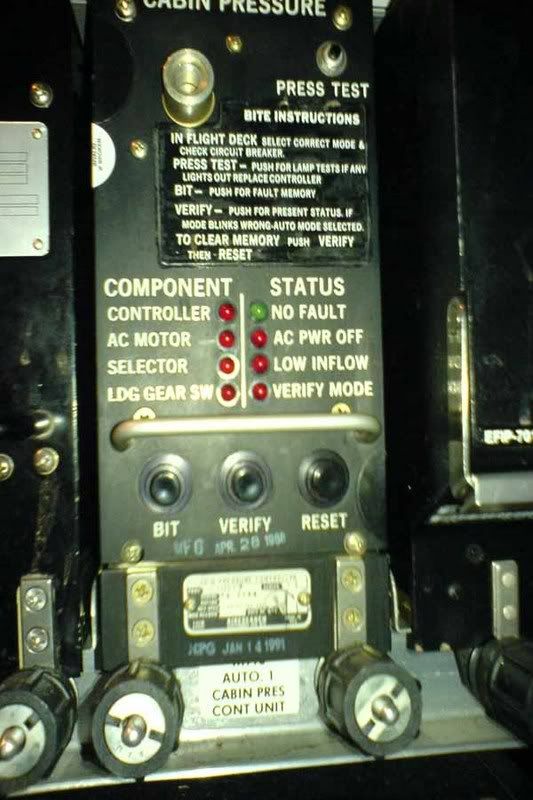

This is selected from the pressurization control panel in the flight deck

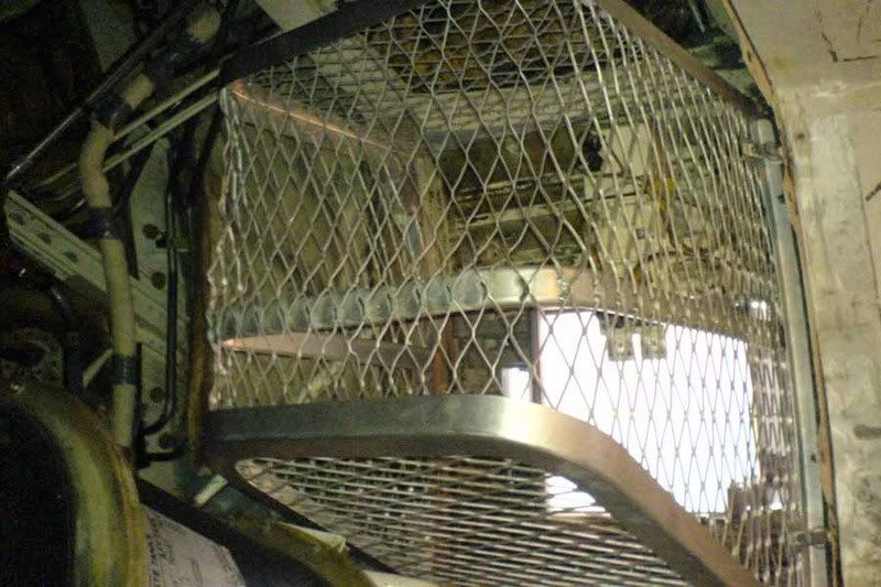

Hear is the outflow valve from the inside, it’s behind the rear freight bay wall

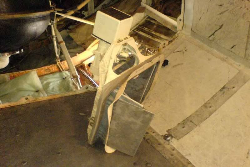

And hear it is removed.
http://i101.photobucket.com/albums/m63/Cking507/DSC00273.jpg
(Three electrical plugs, one bonding lead and twenty two bolts)
