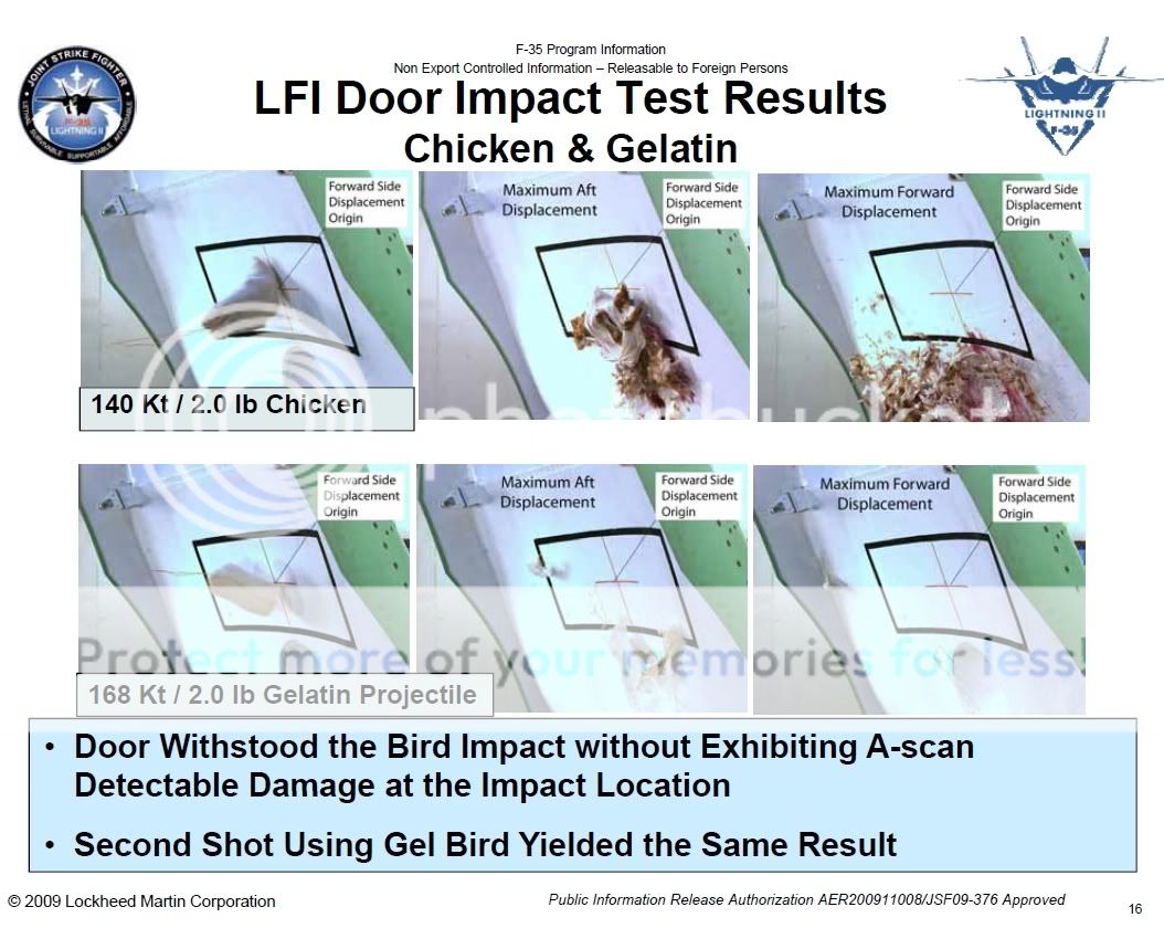

The F-35B’s lift-fan & door should stand up pretty well to birdstrikes. Besides, there is nothing in the fan to “flame out” or otherwise lose performance when struck.
http://i619.photobucket.com/albums/tt271/SpudmanWP/6ac3bd61.jpg
would this mean that once the bird hits the door, it’ll fall into the fan and get diced up into chicken meat for the sailors?
4,849
By: SpudmanWP - 14th November 2011 at 01:46

That door looks like a seagull catcher to me,,
